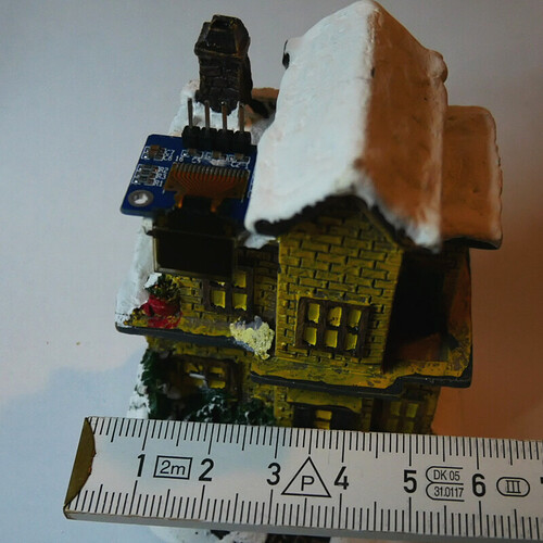

There is some glue between the OLED and the PCB. I just made some pics with the OLED in my lab.
This is the original oled with a 10 Eurocent coin and a cm scale. There is still the green foil display cover on the OLED.
There is some double glue tape between OLED and PCB
So the OLED can be placed on some roof top (display cover foil removed) :o
Oliver
