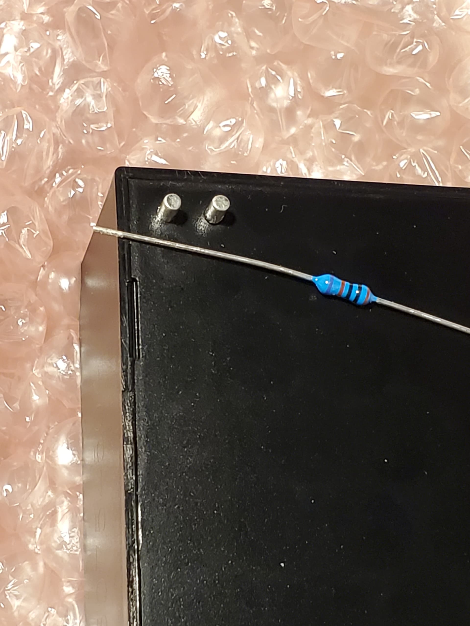

Looking for suggestions on how to solder these 0.08 inch diameter pins (2 mm) to a pcb.
The device datasheet says temperature limit is 360 deg C for 3 to 5 sec.
I have a Sparkfun 937b 60 w soldering station.
Resistor included for size reference.
I was thinking of using the largest tip I have, cranking the temperature up to the max (480 deg C), tinning the tip, and holding the iron against the end of the pin, holding the solder against the side of the pin at pcb interface, and removing the iron as soon as the solder flows.

Do they just set on the pc board? Or do they fit into holes in the board? Either way, heat and tin the pins with solder. Then heat and tin where you want to put them. Finally hold the pins on the tinned place and heat with your iron until the solder that is there melts and then let the pins cool.
You might want to consider a low temp Tin/Bismuth solder.
Thank you. The black material is the housing. I suppose they are connected to a pcb within.
Thx for the Flux reminder.
Thanks. They'll fit thru holes in the pcb.
Thank you. Never heard of that before.

When we encountered something like that in the assembly service, the pins were knurled and pressed into the hole in the printed circuit board. THEN both were soldered.
Interesting. Well, I'm stuck with smooth pins. But tinning everything first sounds like a good idea.
Unless the pins are already a snug fit in the holes - tinning them will then make them no longer fit.

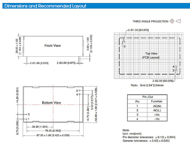

Can you please post some pictures with the PCB mount power supply fitted BUT not soldered into your PCB.
So we can see the area that you are aiming to solder.

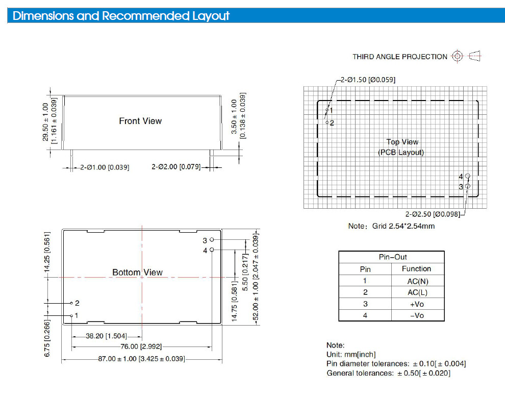

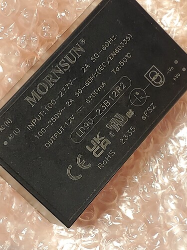

There is a different version that has screw terminals - see the LD90-23B12R2 datasheet.
The datasheet gives you the recommended soldering temperature, as DaveEvans mentioned in his original post.
From the datasheet
FROM THE DATASHEET,

Yep. I regret not getting the screw terminal version.
Thx. PCB is not made yet.
That is more then enough to solder those pins. I made that with a very old WECP-20 Weller solder station with LR20. An 1/8" tip must be enough.
