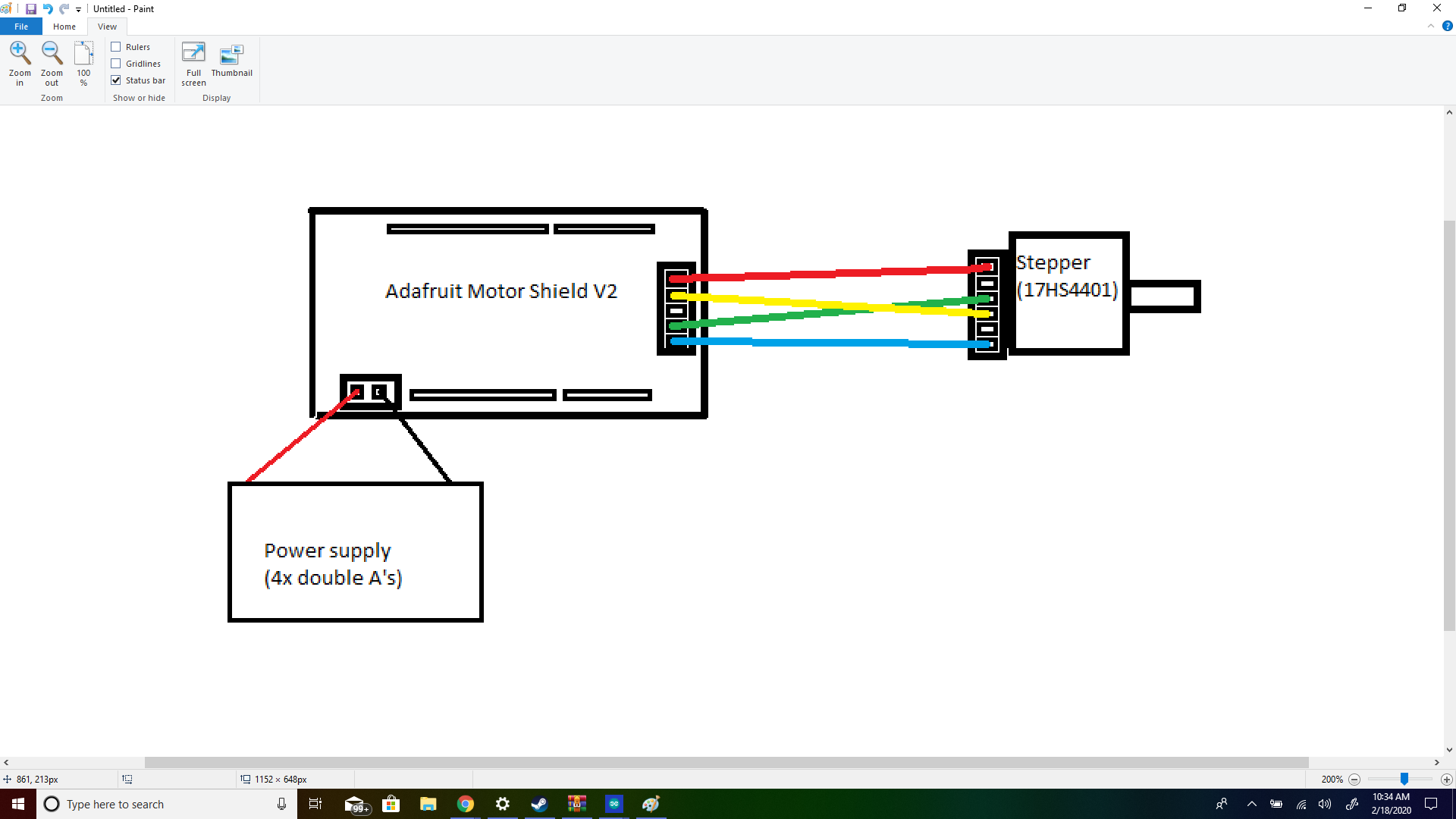

I'm using an Adafruit motor shield v2 and four double A's to try and get a stepper motor to work. I ran some of the adafruit example code just to get an idea of what could be wrong with it. I'll copy/paste that here. This is what happens when I run the code:
With the double steps, it turns fairly quickly but only in one direction (forward)
With interleave steps, it basically does the same thing as double, but slower and a bit more jittery
with microsteps, it just wiggles back and fourth slightly
with single steps, it basically just vibrates a little and doesn't turn at all.
I really don't know what's going on. I'm almost positive I've got everything wired correctly, and I've tried multiple stepper motors (albeit all of the same model).
Here's the code I'm using:
