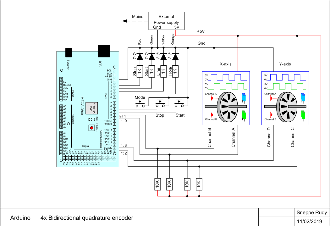

Don't worry. We on the forum know what is wrong:
You will have heard of the expression "the blind leading the blind". (No offense intended to blind people).
You can safely delete that code, it has zero value.
Begin by searching for Arduino libraries for use with encoders. Try out the example code that comes with those libraries.
PaulRB I definately get what your saying. My issue has been that almost all the encoder stuff ive been finding seems to be for the resistive type of encoders and I get no outputs from them. Ive tried probably a dozen different codes and libraries and most have just flat not worked. I had one that worked ok but when i tried expanding to more encoders it just started failing again.
The encoder has NPN open collector outputs, you need a 10k pullup resistor connected from Vcc (5V) to input pin or set the internal pullup with:
pinMode(ENCODER0PINA,INPUT_PULLUP);
Do all of the input pins have a resistor available to code a pullup on? That was one thing that was not talked about on a level i could understand. There is tons of information available out there but its all useless if it takes an immediate dive past what I can understand.
Start with one encoder and the Arduino encoder library.
The on line getting started tutorials (click on Read the documentation in the above link) and one of the encoder library examples are all you need at the moment.
ChatGPT is a complete waste of time for something like this.

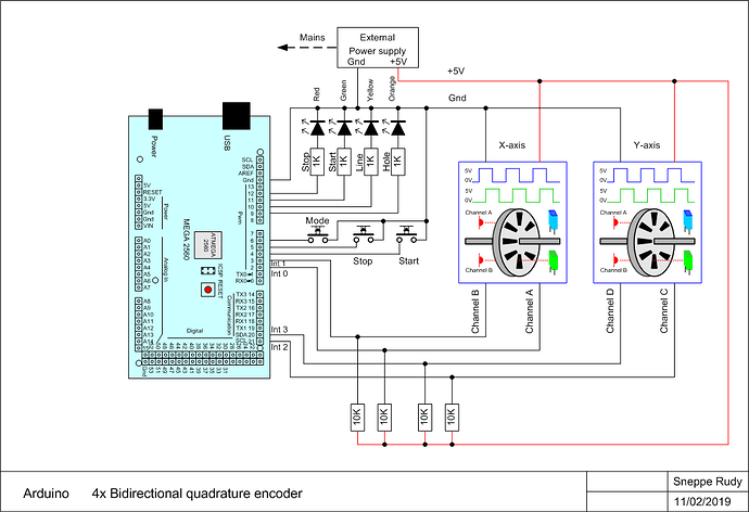

I wrote some code a while back to do something similar.
  Update:   ver.03  08/02/2019
            Clean up unused variables
            Clean up layout
  Purpose:  Double 4x Bi-directional encoding
            to represent the X-Y axis of a 2d object
            and log it in .csv format.
  Board:    Arduino Mega 2560
            Optical encoder open collector
  Author:   Gij Kieken
  Date:     22/01/2019
  Info:     I am using two diferent methods to determine
            the X and Y position
            One with a switch case construction and one
            with an array.

void Achange() {
  A = digitalRead(2);
  B = digitalRead(3);
  //determine state value
  if ((A == HIGH) && (B == HIGH)) stateX = 1;
  if ((A == HIGH) && (B == LOW)) stateX = 2;
  if ((A == LOW) && (B == LOW)) stateX = 3;
  if ((A == LOW) && (B == HIGH)) stateX = 4;
  switch (stateX) {
    case 1:
        if (statepX == 2) countX--;
        if (statepX == 4) countX++;
    case 2:
        if (statepX == 1) countX++;
        if (statepX == 3) countX--;
    case 3:
        if (statepX == 2) countX++;
        if (statepX == 4) countX--;
    default:
        if (statepX == 1) countX--;
        if (statepX == 3) countX++;
  statepX = stateX;
void Bchange() {
  A = digitalRead(2);
  B = digitalRead(3);
  switch (stateX) {
    case 1:
    case 2:
    case 3:
    default:
  statepX = stateX;
void Cchange() {
  C = digitalRead(21);
  D = digitalRead(20);
  //Determine state value
  if ((C == HIGH) && (D == HIGH)) stateY = 0;
  if ((C == HIGH) && (D == LOW)) stateY = 1;
  if ((C == LOW) && (D == LOW)) stateY = 2;
  if ((C == LOW) && (D == HIGH)) stateY = 3;
  index = 4 * stateY + statepY;
  countY = countY + QEM[index];
  statepY = stateY;
void Dchange() {
  statepY = stateY;
Have fun,,,
