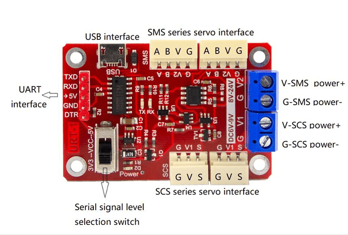

I purchased two STS3215 motors with the FE-URT-1 board. I installed the CH340 driver and the FD SCServo Debug application, then used an Arduino to assign IDs 1 and 2 so I could control them simultaneously. However, I haven’t been able to achieve the following sequence:

Following ChatGPT’s advice, I adjusted the BaudRate (between 0 and 4), set the Status Return Level to 2, and Lock to 0. Since making these changes, no output appears and, regardless of the BaudRate setting, no motor is detected. Unable to find any useful documentation online, I’m reaching out for your assistance.

If the photo does not deceive, you are connecting the servo power supply wrong, you should connect V1 instead of V2.
See
That's what I did, the image is not very clear. Actually, everything was working perfectly yesterday (that's the frustrating part), but I changed many settings in Programming of the FD SCServo Debug application (I shouldn't have), and since then the servos are nowhere to be found. And I have a STS3215 12V with 30kg.cm, powered by a 230V-12V transformer. Is it possible to reset the motors to their factory specifications?

I fixed the problem, everything is back to normal
