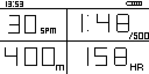

I realise now that I should have been a little more specific. What I want to do is make a 'rowing coach'. It should show the current speed of the boat, the stroke rate, distance travelled and the heart rate. I want to divide the display in four sections, in each section I show one of the types of datas measured. The data measured should update at least every second on the display.
I made a quick sketch that shows what it would look like on a 128x64 display:

search out e-Paper displays .
1 second updates will be quite annoying though, I bet. Would be ok if it's 10 second updates or so.
Does it have to do graphics or would for instance a 20x04 LCD also work (you can of course create a limited set of custom characters to fake simple graphics)?
Would an OLED work? I've seen a few around that size.
I am not sure. What I am reading right now is that OLED gets damaged by sunlight.
It should have customizable graphics and it should at least update every second. I realise now that I was not very clear in my initial description.
I've been working with a wide variety of displays and can recommend two different ones for this use case. Not quite 3", but there's the Sharp memory LCD (2.7" 400x300) and a lower cost 2.13" 250x122 ST7302. Both use very little current while active (<25uA) and look great in any light. Pictured below is the ST7302.
I agree with post#2, e-paper or e-ink displays for low power and my Kindle works very well in bright sunlight.
I'm using a 4" e-ink display with one project. An Uno will be hard pressed to drive an e-ink/e-paper display as they are quite ram intensive and the libraries are big.
