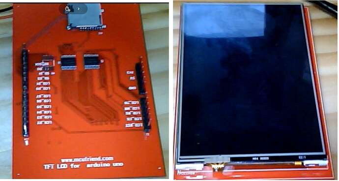

Post a link to the actual screen that you have bought. Make sure that all photos on the link match the item on your desk. Or post a real photo of your real pcb.

UNO R3 Board 3.5 inch Plug and Play TFT LCD Display Arduino Touch Screen Module
http://www.ebay.com.au/itm/141656670946?_trksid=p2057872.m2749.l2649&ssPageName=STRK%3AMEBIDX%3AIT
back of the board has www.mcufriend.com printed on it
Your pcb has major components in the same place but the pcb traces are different to my ILI9488-555.

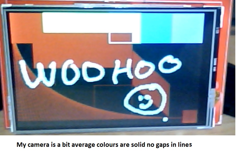

You have a genuine ILI9488. I suspect it is a weird "9488-555" that has a hardware problem.
Library version v2.9.6 should produce a reasonable display but the colours are not perfect.
You must "enable" the support by editing MCUFRIEND_kbv.cpp:
#define SUPPORT_9488_555          //costs +230 bytes, 0.03s / 0.19s
David.
Downloaded 2.9.6
uncommented the #define line
recompiled and installed
I HAVE GOT SOLID COLOURS WOO HOO
Thank you so very much

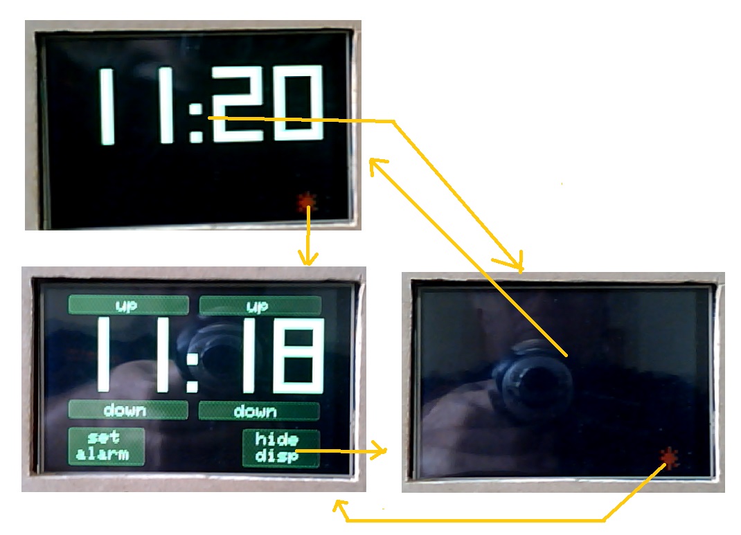

Working clock
