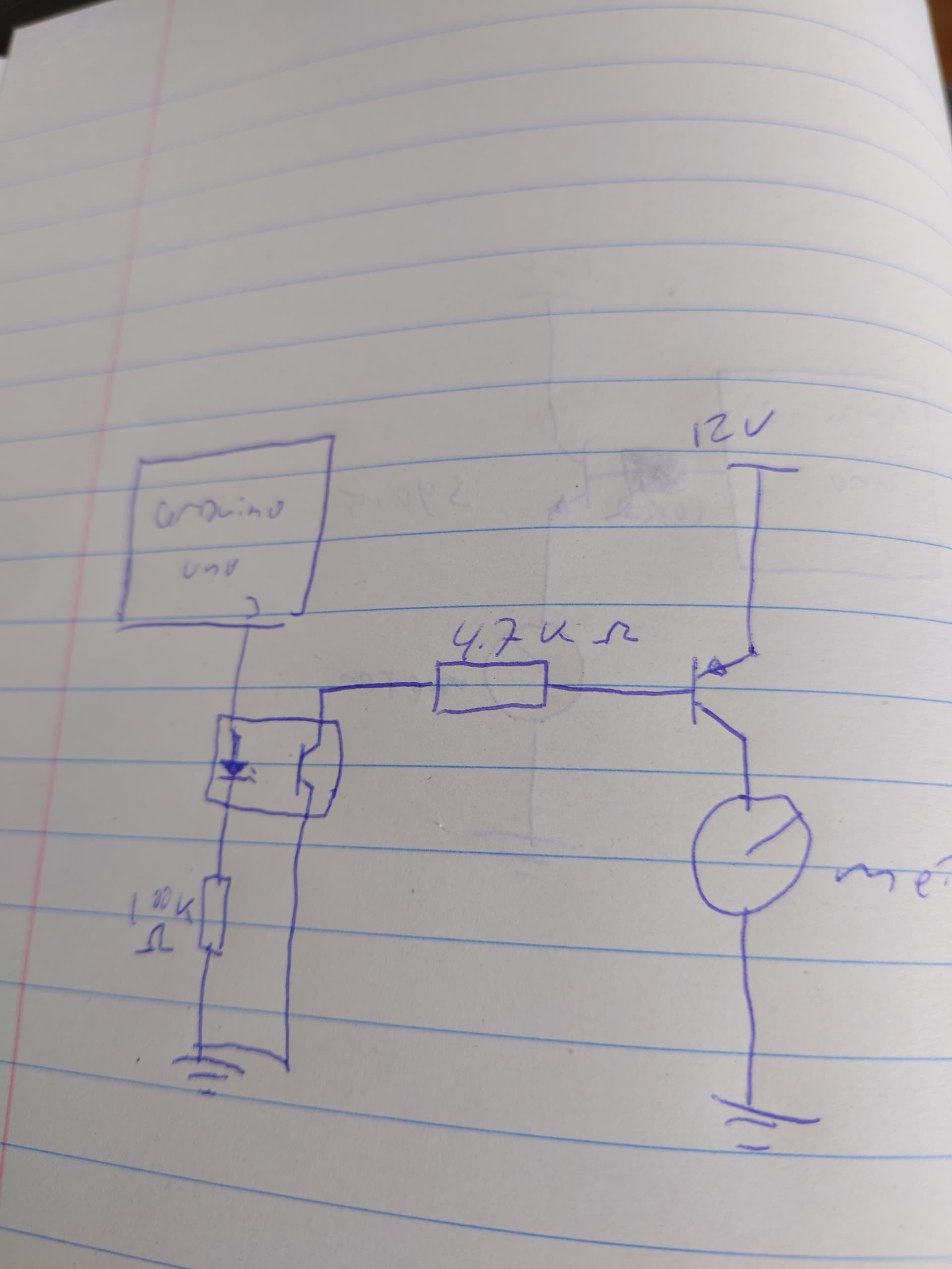

I need to get a 12v square wave to an actuator (Tachometer) with common ground.
So far any use of a transistor i've tried either didn't work or was always on.
I've also tried to use a optocoupler to control the transistor which did work but wasn't fast enough.
This is the basic schematic i use.
Any idea how i can make this work?

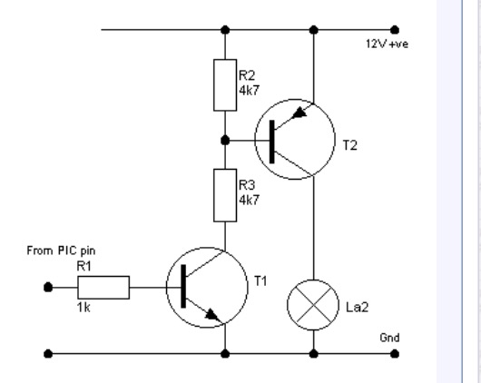

Try a cct. similar to this:

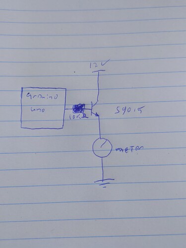

That is an emitter follower, and won't work well. Try the common emitter configuration instead. The transistor must be able to handle the current required by the actuator/tachometer.

I've tried to see if this works.
However now it stays on all of the time.
Even when i remove the T1 it stays on.
I'm using the 2N 3906 and 2N 3904
Show us your wiring.
An optoisolator wasnt fast enough? What frequency are you using?
I now have a circuit that works roughly.
I just cant get it to go past a frequency of 100HZ.
This is the schematic i use now.
Can’t quite make out the values , I would have 560R in series with the led and 1k base resistor for the transistor and say 10k up to + 12v from the base too
Where u have it in the last picture , it needs to be a pnp transistor.
Your code may affect the frequencies you can do .
use Larry's circuit from post #3. If it didnt work you built it wrong - maybe had the pnp & npn mixed up?
You can use the BLINK example to generate a square wave.
Alternatively you CAN use the circuit above; however I'd put a resistor between base and emitter of the transistor - say about 4k7.
You will need a resistor in the region of 470 ohm for the LED. Not 100k.
Just seen Hammy's post - it seems we agree.
I've added the resistors you mentionned and now it works.
All i need to do now is put the right frequency in the code, but i will get to that.
Thank you for your help.
