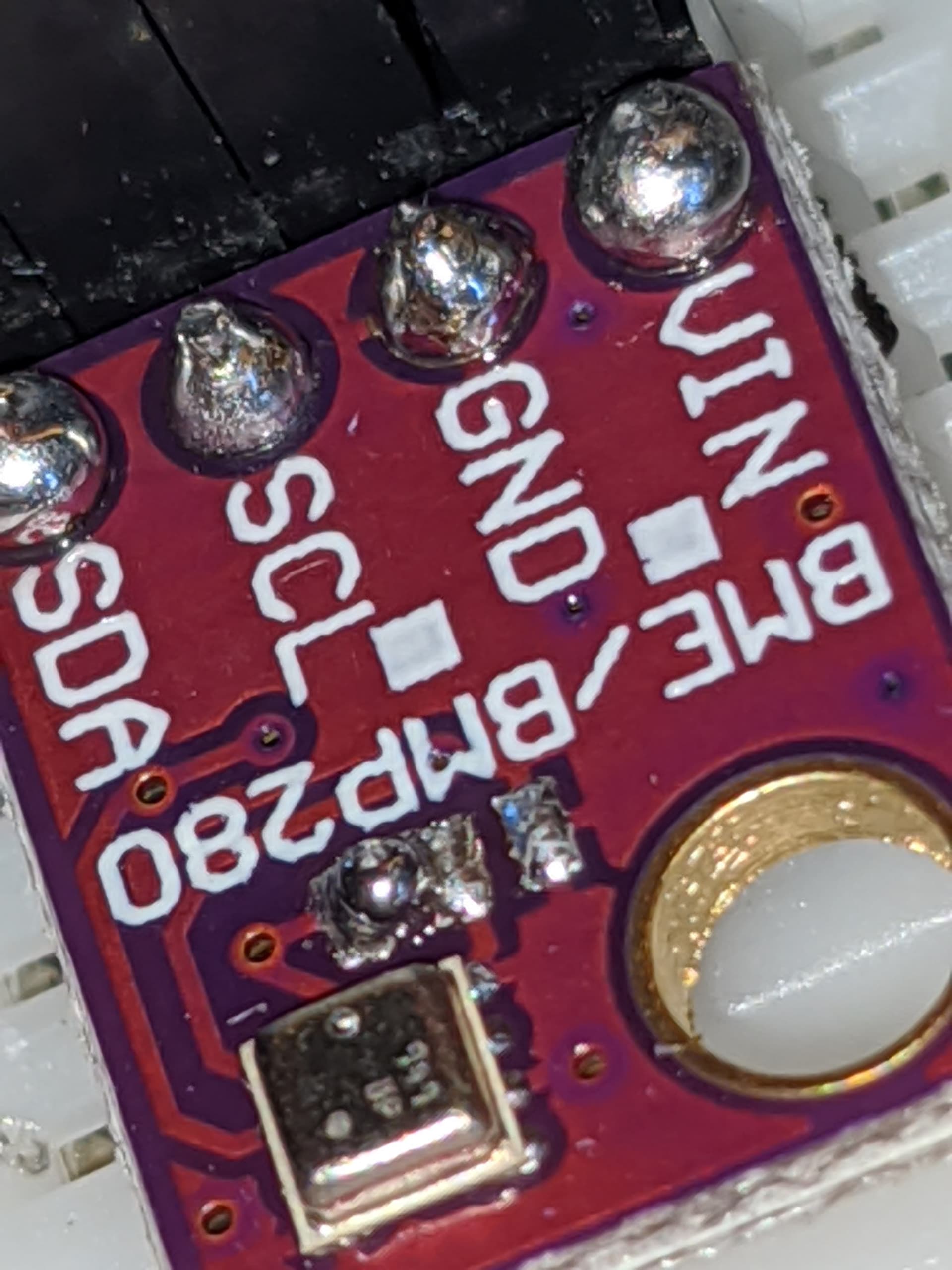

I understand that in order to change the address of the BME280, you have to scratch the trace off between 2 of the ground pads, and then join 2 of the ground pads.
The odd thing is that my BME280 chips didn't seem to have a trace between the two ground pads on the right. So, I just didn't do anything to them, and jumped the two pads on the left.

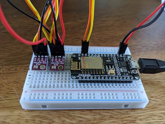

The outcome here is that it isn't being recognized by my NodeMCU.
I have another BME280 chip which I haven't modified in anyway, and it is being recognized by the nodeMCU on the 0x76 channel, which is the default.
When I set them up in series like below, only the unmodified BME280 is recognized. The unmodified chip independently wired to the board gets recognized. The modified chip wired independently to the board doesn't get recognized.

I haven't had much luck using jumper wires with I2C. Sometimes it works, sometimes it doesn't. I usually end up just making a harness and hardwiring it.
The unmodified sensor works with the same jumper cables, so I don't think that's the issue.
I've booted it about 8 times now and the unmodified sensor never fails to be recognized.
There are three rectangular pads on this board. Remove the solder from the left pair and make a solder jumper on the right pair.
Remove orange,
Add blue

WAIT do not change the solder jumper yet.
I believe this is what your board is.....
in the 3 pads circled
the middle is the address select on the sensor
The left is ground
The right is +V.
I'm going to speak from the perspective of the chip you posted lol.

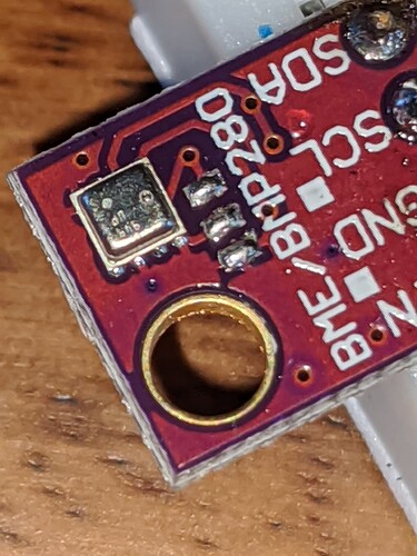

This is a closeup of my unmodified chip:
The chip you uploaded looks like the standard BME280--the pad on the left has a trace line over to the pad in the middle. On mine, that trace line doesn't exist. That's what you're supposed to scratch off, and then you're supposed to fuse the right bumper and the middle bumper.
MAYBE the only trace line coming from my middle bumper is that trace line?

According to the datasheet: "The SDO pin cannot be left floating; if left floating, the I2C address will be undefined".
The middle one needs to be free from the ground area and there has to be a trace that can be scratched away:
a
I found a bunch of bad ones at AliExpress that are similar to yours, with a fault in the pcb design. The SDO is connected to ground area and the solder pads are useless:
bad

When there is no solder on the pcd pads, then you can check if the middle pad (SDO) is hard wired to GND.
