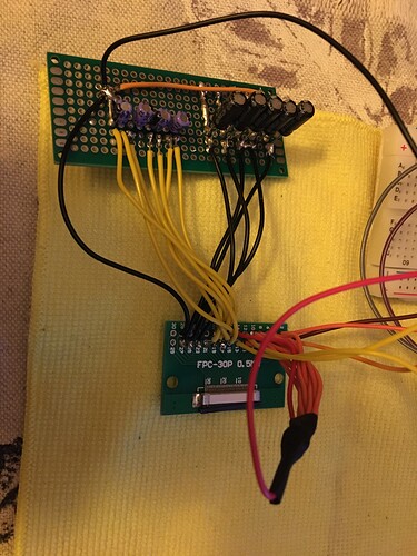

Hello guys!
I bought an LCD display whose nameplate can be found here: https://www.lairui.com/uploads/file/2020614/LG12864K-DW.pdf !
The company sent a word document containing a drawing of the LCD connection! Based on the drawing, the connection panel (3.3V) is ready!
So far there is no problem (soldered, resistors connected in the right places), but they can't tell you which U8G2 should be used for it, apart from ST7565 !! Another thing is that nothing appears on the display (no light, no factory preset icon or anything else)! When connecting, only a few stripes appear vertically and horizontally, but they disappear after a maximum of 0.5 seconds!
Has anyone encountered this display or something similar?
Arduino Mega that I use !!
I have included another part that I think controls the settings of the lcd, for which #include <U8g2lib.h> indicates an error:

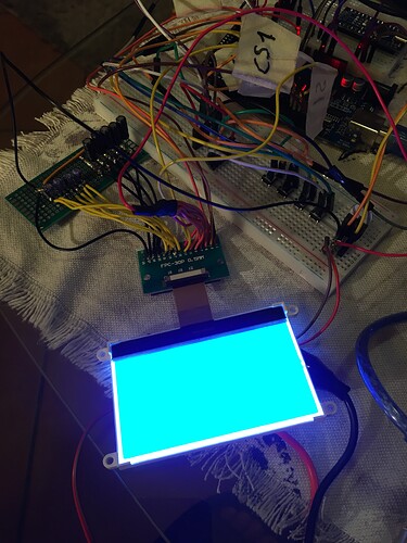

For HW_SPI controllers, stripes appear on the display!
SW_SPI the display is completely empty!
The display receives 3.3V via 7803 mosfet!

I hope that is a voltage regulator and not a MOSFET as stated. Can you post an annotated schematic showing exactly how this is wired, be sure to show all power sources. Also which Arduino are you using? Some of the Arduinos such as the UNO and MEGA are 5 volts and may have damaged your display.
Hi gilshultz!
You're right, I wrote it wrong, not a mosfet if it wasn't a LM7803 stabilizer! https://www.prototypediy.co.za/product/lm7803-voltage-stabilizer/
Arduino Mega 2650 that I use and you can see the drawing of the LCD connection in the first two photos!
I think the problem here is not with the 3.3V, if not with the connection of the Mega pin! I measured the input to the LCD and it was 3.26 V!
In the manufacturer's description, it should be between 3.2-3.3, so the value that the 7803 produces and reaches the display is good! 7803 gets its voltage from the 5V output of the Mega and GND is from there too!
This is the first time I have come across a voltage regulator called a stabilizer, 'prototype' called that in the Spec you posted. You correctly quoted what they said. As you get further into it it also ambiguous called it a regulator. Look up the part data sheet from the manufacturer you will see they missed a lot of information. You need bypass capacitors for it to work properly, they prevent oscillation. I highly recommend you use an external supply until you get it working. Be sure to connect the grounds.
There are so many changes that the white stripes just flash and disappear! So far, the white stripes have been flashing at the HW_SPI lines! I tried all the lines of code linked above, but still no text is displayed!
Can you post an actual schematic of how it is wired. Show all connections, power, ground connections and post links to hardware items that you have not already posted. You show 10 C2s and 8 C1s, your arduino9 has no pin numbers etc. I am not familiar with the display, but I am trying to help best I can.

Now I have modified it so much that I feed 7803 from an external current and the display receives the 3.3V and the ground from there!
