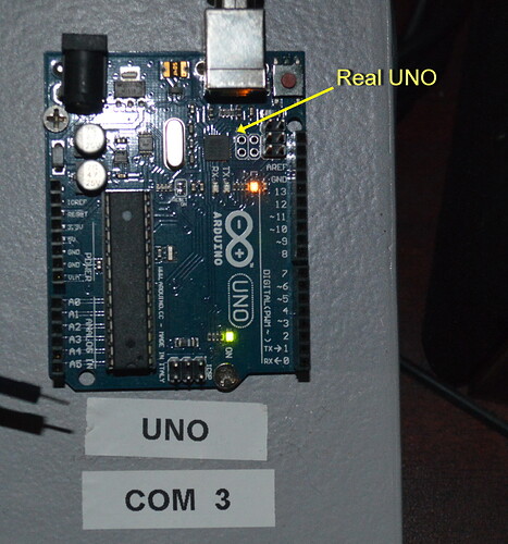

Thank you, I will look into ch340 and give an update. Is there anyway I can tell between a knockoff and a real one? I mean the one I have came with a kit sold on the arduino site and the book for it. I'm new to these boards so I don't know any of the details to them.

If it was from this Arduino site it is NOT a ch340 driver issue
Do you know what type of USB ports you are using and lets see if we can rule that out.
BTW pic of a CH340 board attached.
And an R3 real one
According to your pictures I have a real board as well as it did come off the arduino site. I have 2 USB 3.0 ports and an 8 series enhanced USB made by Intel which might be 3.0 as well. I plugged the board into all of them and the same error came up on all three. The ch340 driver did nothing as you predicted.
