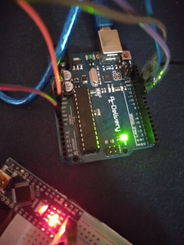

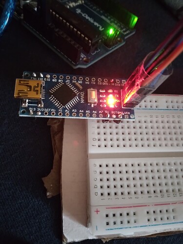

I want to upload a code using arduino uno as programmer and arduino nano as target. I have tried everything but nothing works.

Can you post image of your project with the two Arduinos connected.

And what is the error message?
Eror: Sketch uses 1940 bytes (6%) of program storage space. Maximum is 30720 bytes.
Global variables use 27 bytes (1%) of dynamic memory, leaving 2021 bytes for local variables. Maximum is 2048 bytes.
avrdude: stk500_getsync() attempt 1 of 10: not in sync: resp=0x03

Failed programming: uploading error: exit status 1
What does it mean?
