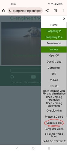

https://qengineering.eu/opencv-c-examples-on-raspberry-pi
Link above is broken.
Thanks @jremington ,
seems this website does not support copied links...
However, if you follow the link you can navigate to the pages using the Hamburger menu:
  • Open the menu
  • Click on
    • Raspberry Pi
    • Raspberry Pi 4
    • Various
    • Code::Blocks
This is for a Pi 4.

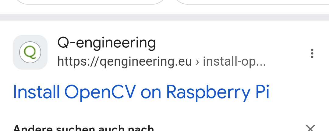

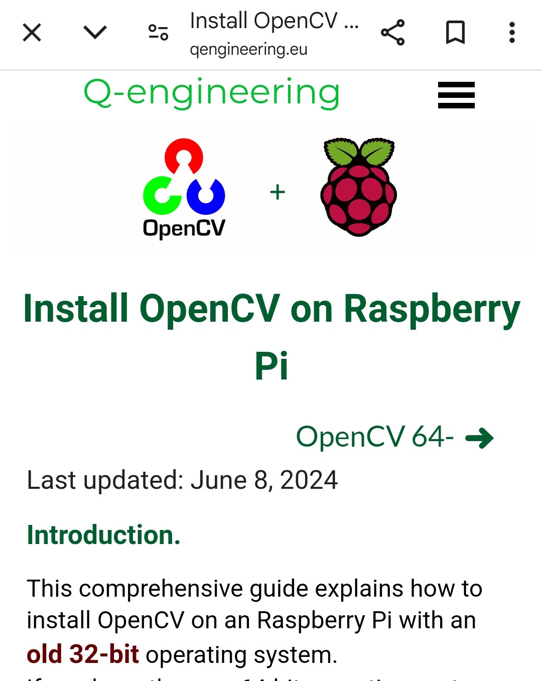

If you use Google with "install opencv raspberry pi" you'll get a link to this page
that works for me but cannot just be copied.
Regards
ec2021
The link on Google looks like this
