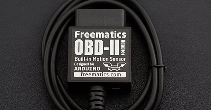

or a Freematics
If the wrong info is put onto the can buss the question is what will receive it and how will it be interrupted. It's best to use a ODBC simulator but they cost a poo! load of money.
