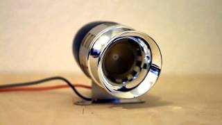

Hi all,
I would like to turn on a 230V stroboscope and a sirene with a solid state relay.
On a arduino micro, max current output 20mA
I have googled and searched to no avail ![]()
The relay I would like to use is this:
Solid State Relais - Sharp S202S02
Can I connect it like above ?
From the datasheet:

Can I connect the an output directly to this relay or should I use additional components like a current limiting resitor.
Or do I Need an additional "snubber circuit" to have reliable operation ?
