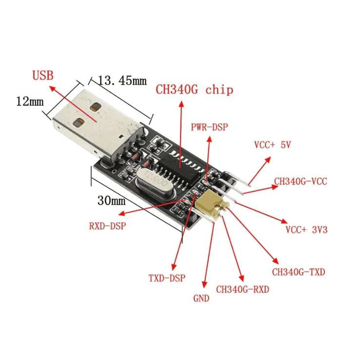

This is the device : Buy CH340G Serial Converter USB 2.0 to TTL 6 Pin Module Online in India | Robocraze
Putting jumper between VCC and 3.3V is expected to give 3.3V ttl signals

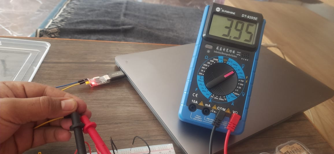

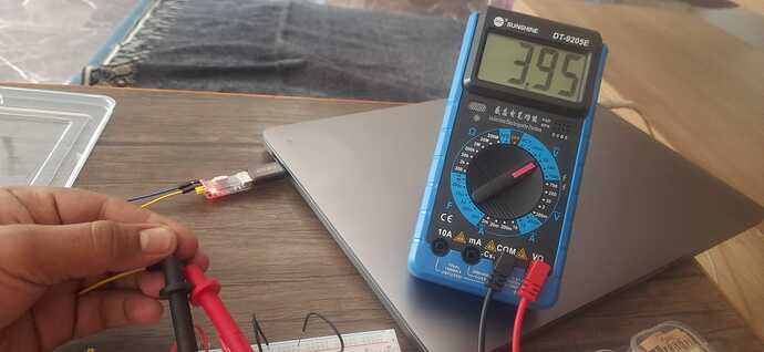

Below are the images i took from breadboard - Its show voltage between Tx and GND of ch340G (3.95V)

That is true but you are measuring 3.8 to 4V so I would say that the converter is no good
@jim-p but it should be close enough. Eg in last screenshot, its 3.95V which is close enough to 4v
and devider should have given me around 3.3 (even if not exact)
The issue is, drastic voltage drop from 3.95V to <2V as soon as there's voltage divider
My point is that if you set Vcc to 3.3V then the output should not be higher than 3.3V so the converter must be defective.That is why a voltage divider is not working.
Ah, is there a way to "test it" - coz this is brand new, just arrived. But i agree, it could be defective
Basically you just did. If the output is supposed to be less than 3.3V and it's not then something is wrong.
