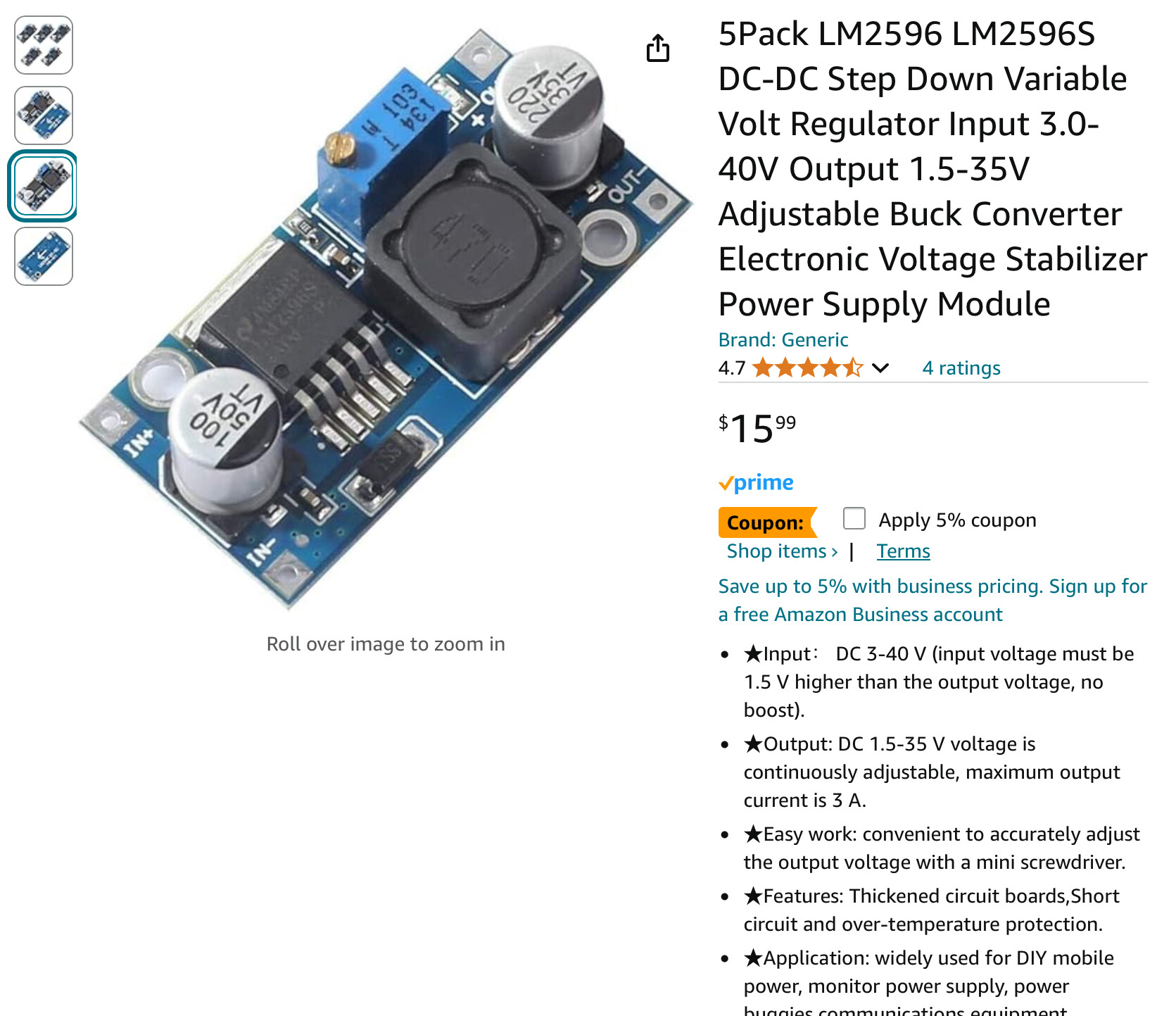

  • Today most would use Buck Converters.
$3.00 each
