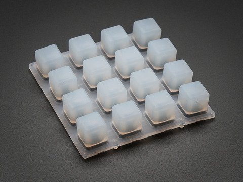

3) That's a custom rubber button or pad - designed for use on a PCB with appropriate traces to match the conductive carbon part on the underside of the pad. Not a standard item I'm afraid - spares for some existing device might be a possible avenue.
You might like to see if these silicon buttons are what you are after https://www.adafruit.com/product/1611

Grumpy that is a bit too small for what I was thinking, but I they would definitely work for something else I wanted to do.
Too small buttons or not enough? Did you see the links on that page to devices with many more buttons.

They are much too small. No I didn't see that, I looked again and still can't find it.

Well their is a picture and link off that page I posted to this:- https://learn.adafruit.com/untztrument-trellis-midi-instrument
And off that page their is a link to an even bigger one:- https://www.adafruit.com/product/1999

Ohh cool Grumpy, ya I was having trouble finding those. They are a bit too small for a drum pad, but still pretty cool and can already think of using for an addition to the drum pad.
