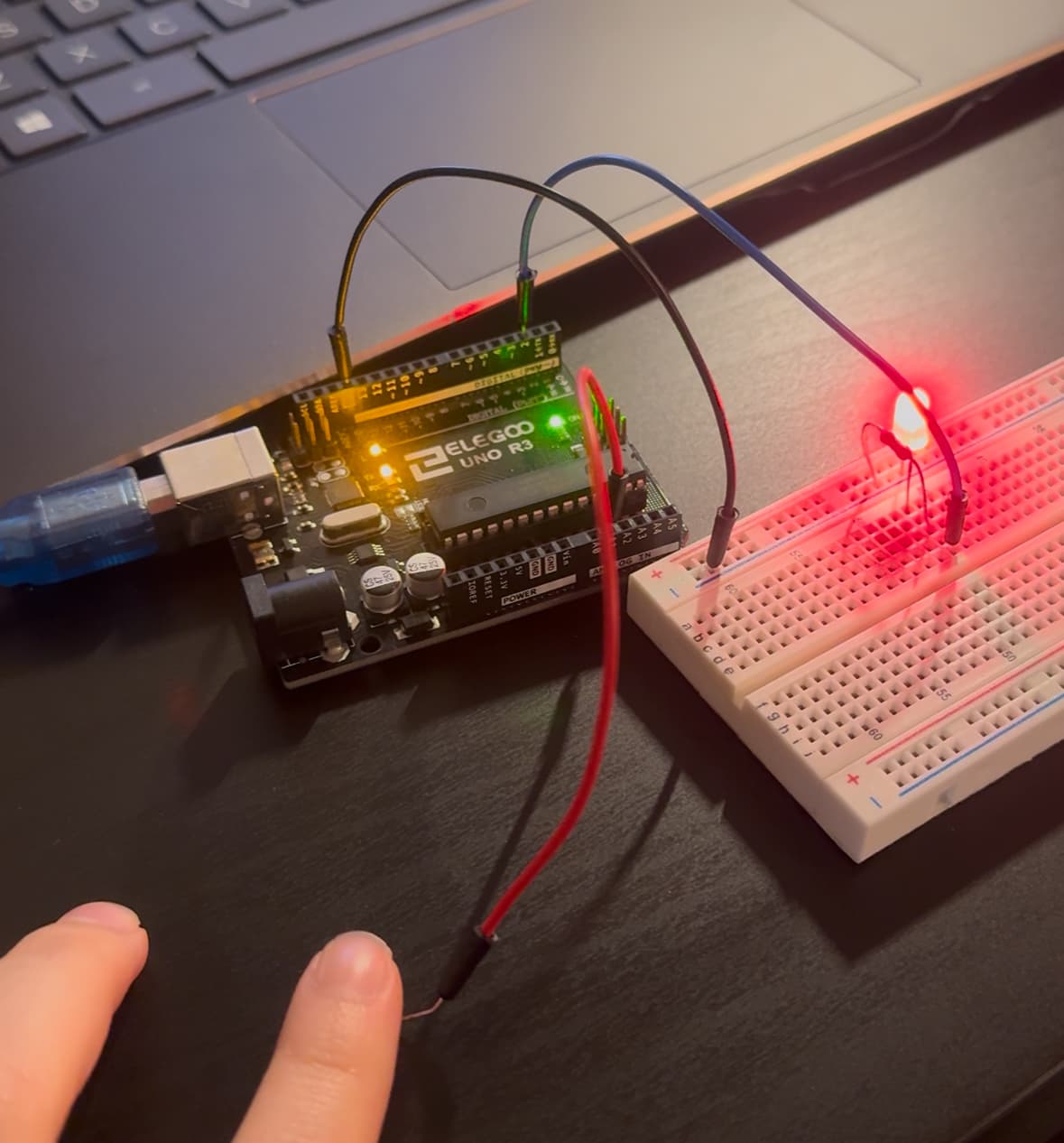

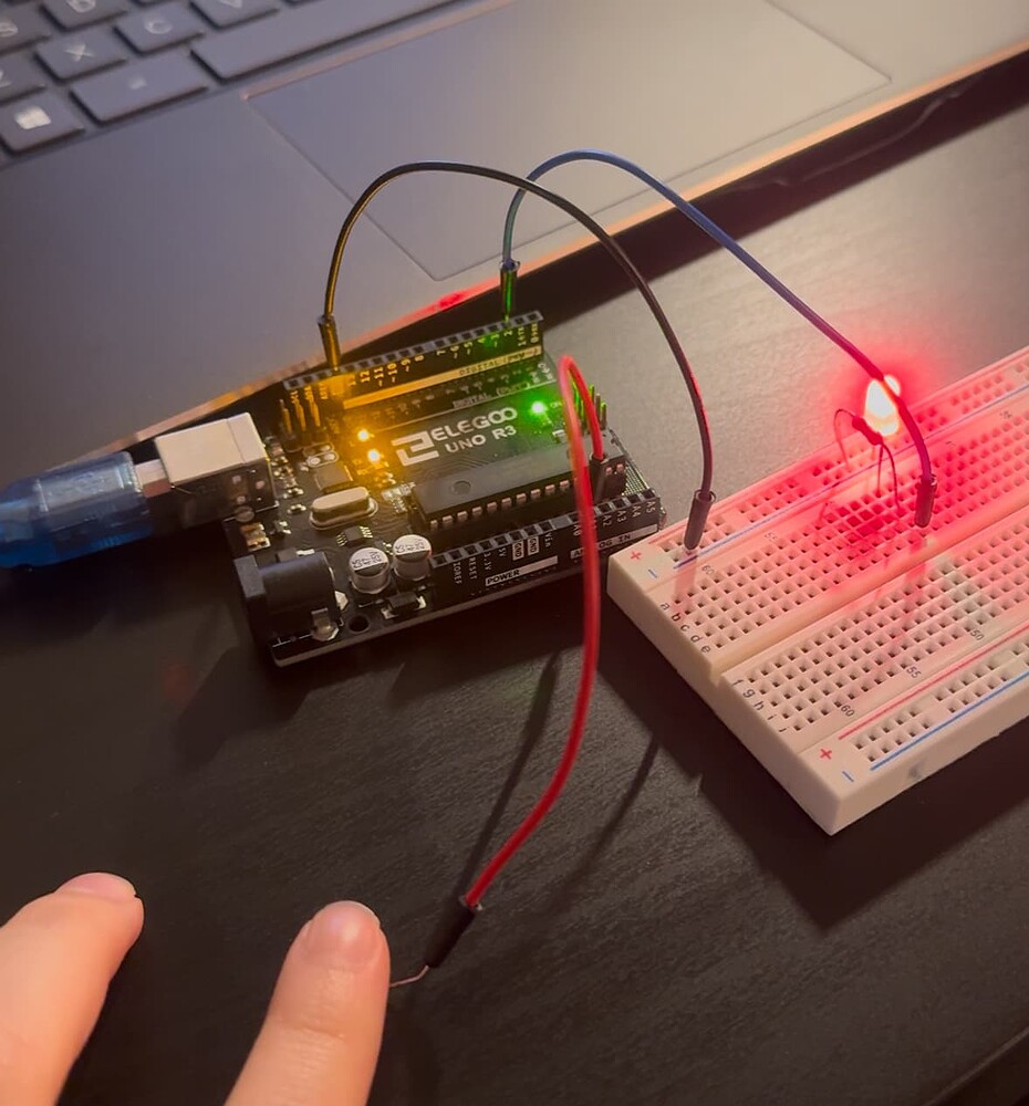

I am trying to find out which sensor can detect small objects that don't have a high capacitance. I built a simple circuit that uses a 330 Ω resistor and an LED. The light turns on when I touch the analog wire, but if I place any small object on it, it does not turn on.
  • Your LED is not wired properly, you will damage your Arduino.
    :scream:
  • Wire as D2.
You need to define these objects, and what they are made of. Without that information you cannot get an accurate answer.
(post deleted by author)
I believe its made out of platinum
Is that what you are sensing? What size ie. define them.
Yes, it's a small size platinum piece that's < 3mm
Is this some type of security thing? Without more information about your secret device there is not much more I can offer.
That is because you need two wires to measure capacitance.
Where can I add the second wire
  • When a large object comes to the sensor wire, the object is detected.
  • The operative word is large.
To GND
