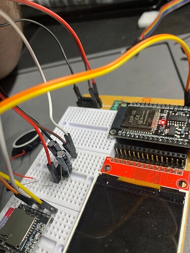

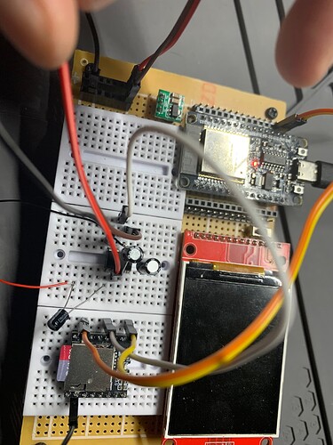

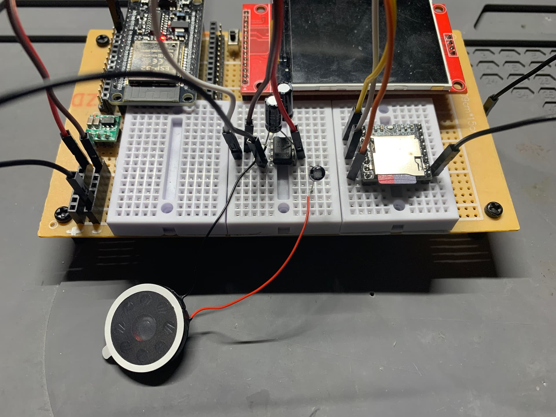

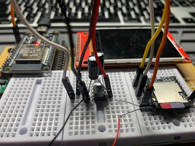

Not the greatest setup but not bad for a quick throw together.
The 2 big caps are 10uf and the small one going to the speaker is 22uf.
I used this circuit below for the LM386.
And just straight piped pin 4 (DFPlayer) it into pin 3 (LM386)

The LM386 is considerably less powerful and has higher distortion than the amplifier built into the MP3 player module.
