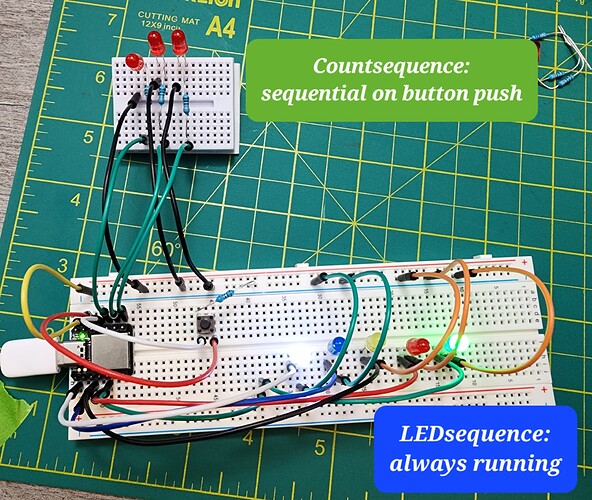

Appreciate the response, I'm new and not sure exactly how to do all this. Attaching a picture and the formatted code was provided below.

Exactly! I do not mind if the while loop restarts upon button push, as long as the if LED remain illuminated. I understand this may not be possible on one Seeeduino XIAO (the chip I am using in replacement of the UNO R3, but trying to exhaust all avenues before resigning to adding another XIAO to the project.

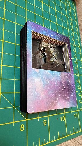

This is a picture of the project. I will have the CR2032, XIAO, and LEDs nested throughout the cards to illuminate the art.
LEDs require current limiting resistors !
A common LED needs a series resistor to limit the current flow to a safe level ≈ 10mA.
  • Driving a LED directly from a controller output will damage your controller.
Nice clear images !
:+1:
Even with the XIAO being a 3.3v output? I used the resistors on the 5v output of the UNO R3, but didn't think they were necessary with the lower voltage output on the XIAO. (it is 5v when plugged into computer, but runs off a CR2032 when used in the project)
Yes
example:
Assume the LED has a forward voltage drop of 2V and we need 10mA of current.
3V3——[ Resistor ]——[A—>|—K]——GND
R = (3v3 - 2v) / .010A = 130Ω
Thank you! Added 330 resistors to the set.
330 Ω will allow ≈ 4mA, most common LEDs will be bright enough at this current.
