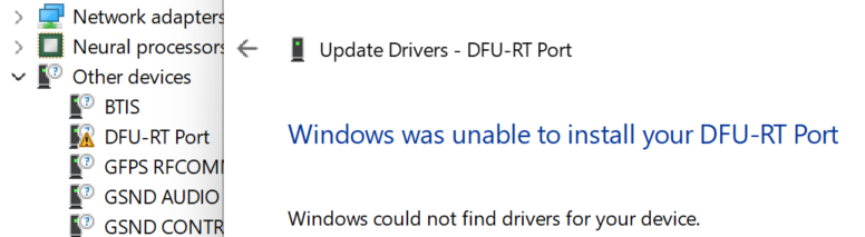

Uno R3 works fine, no issues, no slowness.
Uno R4 minima and ESP32 however, are unusable. It seems that there is no DFU-RT driver available for windows on arm. The IDE can see the board, but can't upload. Both work fine with the same cable on my x86 laptop
Cannot open DFU device 2341:0069 found on devnum 1 (LIBUSB_ERROR_NOT_FOUND)
No DFU capable USB device available
Failed uploading: uploading error: exit status 74

I have verified that the UNO R4 Minima works fine with the WinUSB driver installed via Zadig on a Windows x86 machine. I didn't bother to test it with an ESP32 board, but I'm sure it will work as well.
Unfortunately, Zadig has failed to install any drivers.
ESP32 will work, but you can't use the setup.exe. Download the Windows Universal Driver from Silicon Labs. Find silabser.inf and right-click>install to get the driver to install. Don't use setup.exe. It will tell you that it's not compatible. Just got this working today.
Please provide a detailed description of what you mean by this in a reply on this forum thread, including:

Quite simply,
  • I run Zadig as an admin with the R4 connected.
  • Zadig identifies the device as DFU-Port (Interface 2).
  • I have tried to install WinUSB, USB Serial, and libusb-win32
  • Install Driver, or Install WCID Driver, neither changes the outcome.
  • Zadig gives the same errors each time.
    • As a popup: "The driver installation failed."
    • At the bottom of the Zadig window: "Driver Installation: FAILED (Operation not supported or not implemented)"
I have also tried installing the DFU-RT_Port_(Interface_2).inf file directly by extracting them, but they also fail with: "A certificate chain processed, but terminated in a root certificate which is not trusted by the trust provider"
pbatard has stated that Win11 on arm64 won't accept Zadig drivers without disabling DSE. And my Galaxy Book4 Edge steadfastly refuses to boot with DSE disabled.
https://github.com/pbatard/libwdi/issues/289#issuecomment-1848986132

libwdi:debug [syslog] >>>  [Device Install (UpdateDriverForPlugAndPlayDevices) - USB\VID_2341&PID_0069&REV_0100&MI_02]
libwdi:debug [syslog] >>>  Section start 2024/08/29 19:52:47.218
libwdi:debug [syslog]       cmd: "C:\Users\amoor\usb_driver\installer_arm64.exe" "DFU-RT_Port_(Interface_2).inf"
libwdi:debug [process_message] Switching timeout back to finite
libwdi:debug [installer process] This version of Windows is refusing to trust the installed certificate.
libwdi:debug [process_message] Installer process completed
1 device found.
libwdi:debug [wdi_create_list] Hardware ID: USB\VID_2341&PID_0069&REV_0100&MI_02
libwdi:debug [wdi_create_list] Compatible ID: USB\COMPAT_VID_2341&Class_fe&SubClass_01&Prot_01
libwdi:debug [wdi_create_list] Driverless USB device (5): USB\VID_2341&PID_0069&MI_02\5&17EB51C6&0&0002
libwdi:debug [wdi_create_list] Device description: 'DFU-RT Port (Interface 2)'
Thanks for the clarification, and for the link to the valuable information in that related issue.
Unfortunately I'm completely out of my depth here due to lack of knowledge regarding the low level workings of driver certificates and Zadig, and due to lack of a Windows ARM machine to run any experiments on. So I don't think I can be of further assistance to you. Hopefully one of the other forum helpers who are more knowledgeable on the subject matter can help.
If you haven't already, I would recommend spending some time investigating this. If you can find a way to disable driver signing enforcement then I think you will be home free, and although you should be very careful when it comes to drivers, I do think you can trust the driver provided by Zadig; most especially WinUSB since this actually Microsoft's own driver.
I recommend focusing your efforts on WinUSB.
I don't think USB Serial will work since this is the DFU-RT device rather than the CDC device.
Although it probably is appropriate for the device, I'm not sure whether the libusb-win32 driver is available for ARM hosts. The situation for libusb-win32 might be similar to that described for libusbK:
https://github.com/pbatard/libwdi/issues/155#issuecomment-1446020096
there will be no libusbK.sys for ARM/ARM64. Rather the focus is to support WinUSB.

Did anyone get this to work I have a new Surface 11 with an ARM processor and cant update my Uno R4. I have tried Zadig with all its options, tried installing the drivers manually, I even looked on the Renesas web site to see if they had new drivers, with no success.
So I've got this working for ESP32 now.
