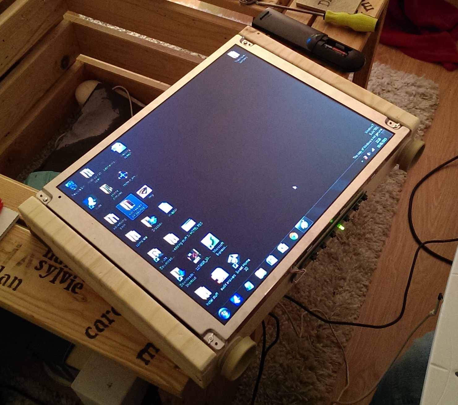

I am currently building a home system using an old vaio laptop and an external monitor. The monitor is just standard and the laptop insides are based behind the screen encased in a custom build box (see image attached). This is to be attached to the wall therefore im looking to make the screen a touchscreen but i want to build it instead of buying as this is a completely DIY project.

Hi, welcome to the forum.
As far as I know, a capacitive touch screen is okay. Other things are not. A homemade location sensor for a finger will not work properly to operate the screen. Sorry. Can you buy an old laptop or tablet with touch screen ? You can use the Arduino to control lights, and read sensors, and so on.
I don't think the Texas A&M Zerotouch could be controlled by a low end ATMega. But a simple single touch X-Y arrangement might be feasible: Infrared Grid You would then emulate a touchpad Human Interface Device.
