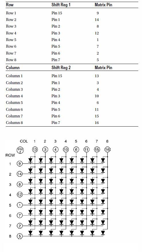

I'm attempting to be able to control a single 8x8 red led matirx, being able to display whatever I want on it.
I've looked at a few tutorials and the guide in 'Beginning Arduino' book. I believe I have wired the led matrix correctly, however all that happens is everything lights up for a minute or so, then goes off. This behavior doesn't seem to be affected by code.
I've attached some images to show what I've got so far.
Matrix Wiring.jpg - This is how I've wired up the LED matrix to my 2 595 shift registers. It matches my matrix datasheet for the correct pins.

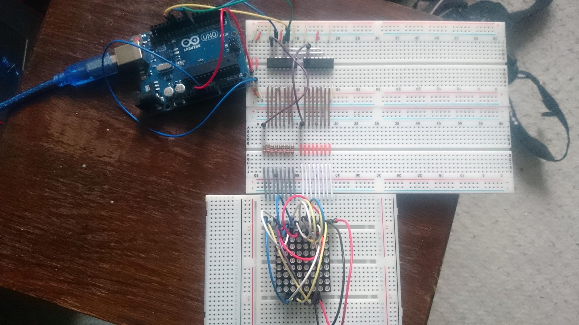

Breadboard Layout Photo.jpg - The real prototype.
I expect I'm missing something obvious and any help would be appreciated. Let me know if there is other info I need to provide also.
There are two types of 8x8 LED matrices: row anode-column cathode and row cathode-column anode.
Are you certain about which type you have?
It is a 1088BS, as is printed on the side. From looking around I believe it to be Row anode column cathode.

Thanks for the advice. Unfortunatly that code didn't make a difference, so I guess something is up with my circuit.
I'll have a look at the MAX7219 chip instead though.
On your second ( right ) 74HC595 : Pin 14 Serial DATA input is not connected ( to Arduino or to pin 9 of the firtst ( left ) 74HC595) :o - isn't it ?
