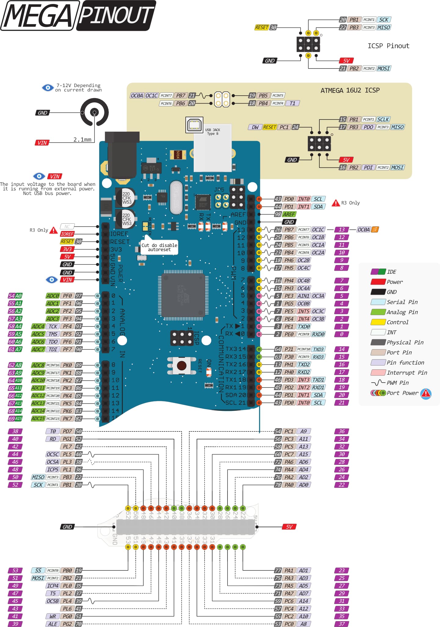

Here is what I see in your sketch... which looks like you want to drive 4 motors (pins 3, 11, 12, 13). You need up to three pins per motor: forward, reverse, enable
  //Setup Channel B
  pinMode(13, OUTPUT); //Initiates Motor Channel B pin CW Direction
  // xfpd: This does NOT establish a CW direction. It configures digital pin 13 as an OUTPUT pin
  //Setup Channel A
  pinMode(12, OUTPUT); //Initiates Motor Channel A pin CCW Direction
  // xfpd: This does NOT establish a CCW direction. It configures digital pin 12 as an OUTPUT pin
  //Motor B forward @ half speed
  digitalWrite(13, HIGH); //Establishes forward direction of Drone Channel B
  // xfpd: This does NOT establish "half speed"  D13 is digital I/O.  "Half speed" requires a PWM pin
  analogWrite(11, 255); //Spins the motor on Channel A at full speed
  // xfpd: in THIS sketch, this pin has NOT been configured as OUTPUT so it does NOT spin a motor at any speed
  //Motor A forward @ full speed
  digitalWrite(12, LOW); //Establishes forward direction of Drone Channel A
  // xfpd: if pin 12 is attached to ENABLE of the motor driver board, this will stop the motor
  analogWrite(3, 255); //Spins the motor on Channel A at full speed
Here is an example of how to drive TWO motors... and if you have any questions, please, ask.

This image shows the pins for your MEGA2560... you want one PWM pin per motor to change motor speeds... look for the "tilde/squigly" lines labeled "control" representing PWM pins.
Adding a "PWM" example image from ArduinoGetStarted.com to show controlling motor speed.
