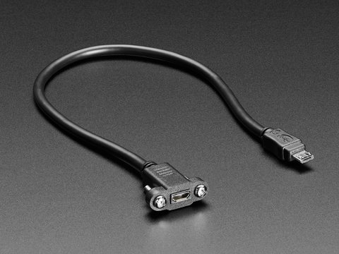

If you are putting it in an enclosure, you can get panel mount USB extensions. That way the user yanking on the cord doesn't exert any stress on the board.

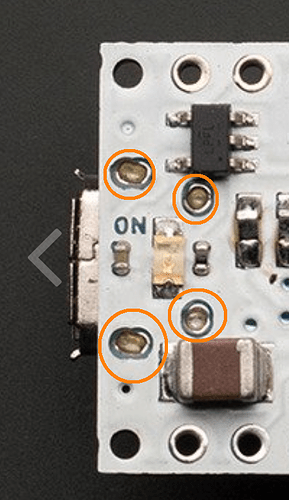

There seem to be solder pads next to the connector; maybe a bit of extra solder on there makes it a bit stronger.

You can consider a panel mount micro usb connector; you can get them with a cable that will fit in the Pro Micro.

Yes, it's quite unfortunate how much space those panel mount extensions take up. You can find them with a right angle micro plug, which makes it more compact. But even then the too-long cord is taking up a lot of space and making things messy. I ended up making a small one by cutting it down to the length I needed and splicing the right angle micro plug on there.
I think the adapter solution is reasonable, but only if you can figure out how to mount the adapter securely to the enclosure.

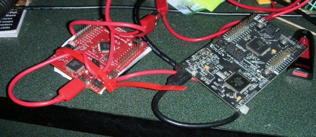

In the "Microcontroller MOOC" using the TI ARM Launchpad, students had problems with them tearing off, and were specifically cautioned to be extra careful (and/or implement some sort of strain relief as shown below:)

Also, it looks like some boards (like the Genuine Arduino/Adafruit "Arduino Micro" are at least laid out to accept a tabbed USB connector (I don't know if they're actually manufactured with one; the board looks designed to take several different connectors...) (The Adafruit Feather and ItsyBitsy 32u4 boards also seems to have a connector with tabs, and they specifically mention "the new version of this board has a better USB connector) on one of their products (which I can't find now.)
