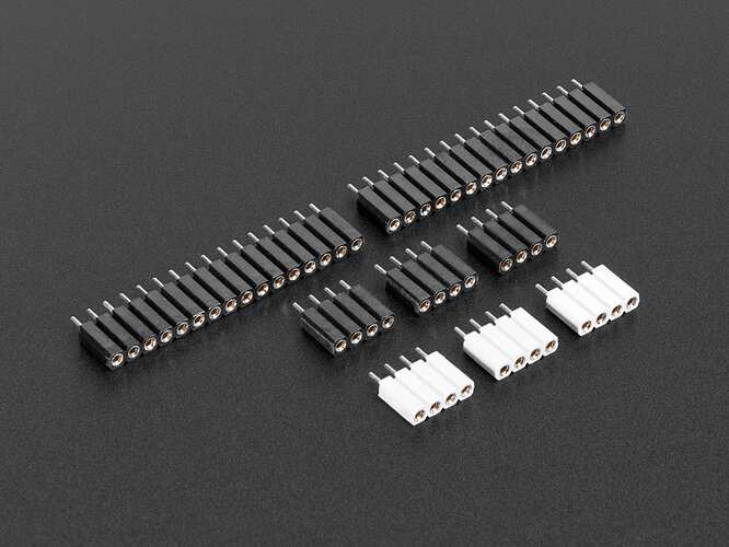

Thank you. Would you be able to point in the direction of where to find these pins? I can't tell from the beetle product description if there's a particular size, and all the ones I find come in blocks of over four pins and don't appear to be able to be broken up in to smaller pieces.
The closest I've found are these:
Standard header pins often come in blocks that you snap off or cut to fit, and have spacing 0.1".
I buy pins, connectors and jumper wire sets from Pololu but some Beetle sellers provide pins with the product.

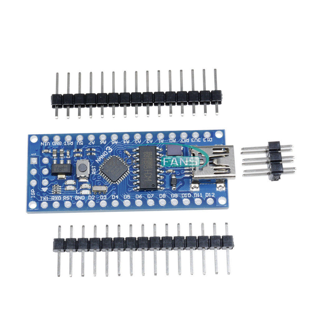

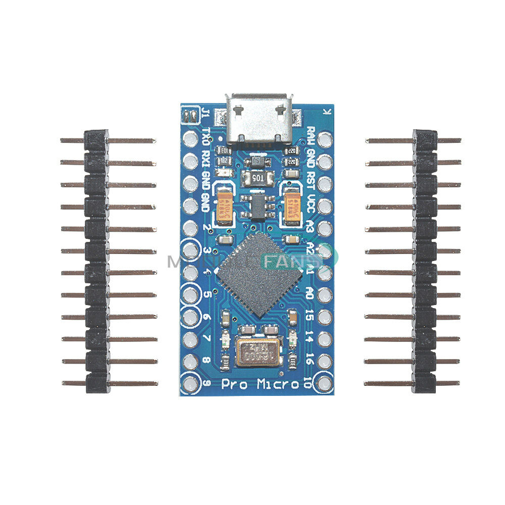

In regards to eBay, this is an unbelievably expensive module!
Considering it is just a single chip and a few other components on a tiny PCB.
More expensive in fact, than a Pro Micro! :astonished:
Which is in turn more expensive than a Nano.

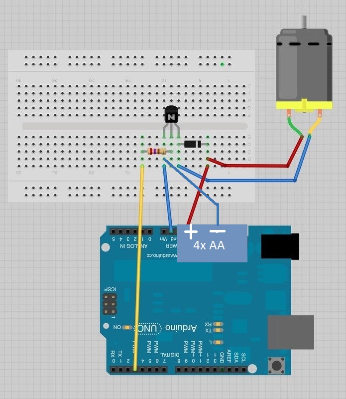

So far I've used this layout (but with an electromagnet instead of a motor):
Is the diode necessary for an electromagnet?
Thanks
In the circuit you linked, the transistor is the driver. However, in that circuit, Adafruit makes the common but terrible recommendation to power the motor from the Arduino 5V outlet. Don't do that as it can damage the Arduino (of course Adafruit will be happy to sell you another).
For any motor or coil, the diode is absolutely required.
To power your solenoid, use either a 5V phone charger or 4xAA battery pack. Don't forget to connect the grounds.

I'm a bit confused as to how to connect it and ground everything. In the adafruit diagram, the 5v goes from the ardunio on to the breadboard connecting to both the diode and the motor.
But if I replace the 5v pin with the AA batteries then the tracks will still burn as the current will be too high.
Use wires for high currents, not breadboard tracks. If you don't know how to solder, there are plenty of on line tutorials (Sparkfun, Adafruit, etc.).
So would the attached diagram (soldered on pcb instead of breadboard) be correct? I've basically just replaced the 5V and gnd pins on the arduino with those of the battery pack.
Or does the gnd pin on the arduino need to also be used?

Well, now you are missing a connection from the ground of the battery/ power supply to the Arduino ground. At least the original diagram had that implicitly. :astonished:
Thanks for your replies. Would the attached be correct then?
Looks about right. :grinning:

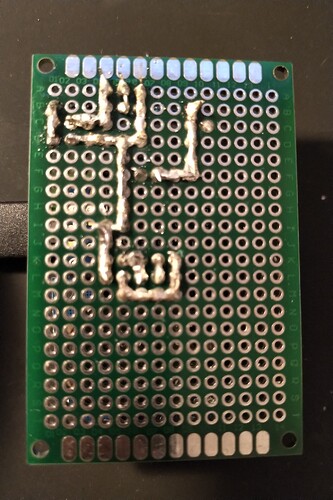

Got it working :slight_smile: However, when I switch on the trinket it appears to malfunction. Just the solid green light and faint solid red light. It is not recognised by my PC.
If I unplug it from my PCB board and then switch it on it is OK. The red light flashes as usual as it boots. Then if I plug back in to the PCB board (keeping it switched on), it behaves fine.
I believe this was only a problem once I'd soldered in the resistor, transistor and diode.
I have attached my work.
Short of starting again is there anything I can try to resolve?
Update: I resolved by resoldering the L that goes from D to 6 :))
