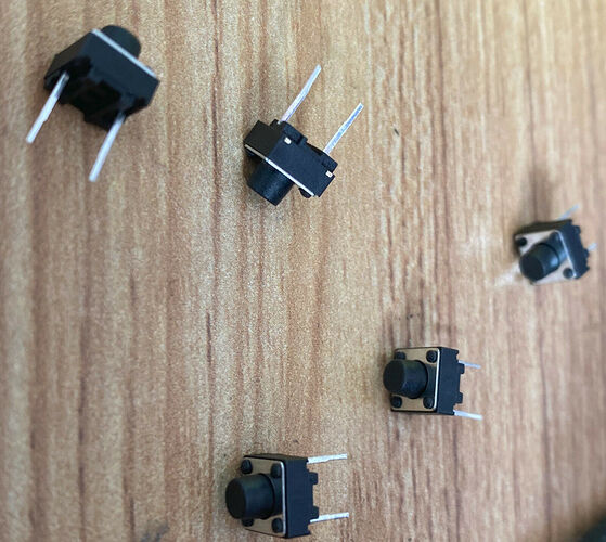

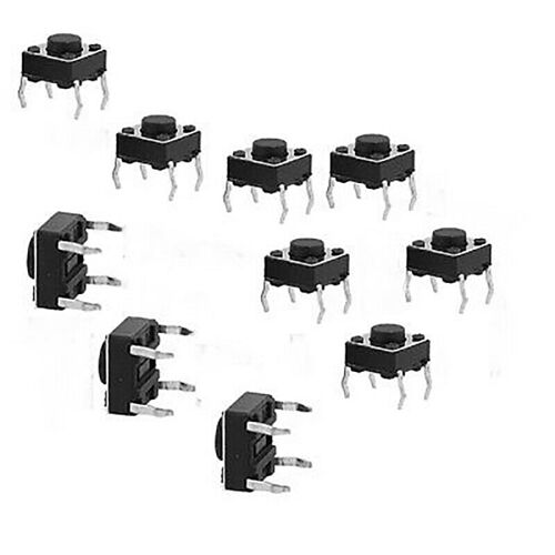

I tried to get some little push buttons 5.9x5.9mm outside - common type with slightly crimped legs
the spacing (pitch is 5.25 one way and 6.6mm across). You cant insert these into a BB without undue force - even then the insertion length is only 3.5mm - unreliable
A UK supplier on EB has twigged this and advertises his buttons as breadboard friendly (no personal interest here btw)
https://www.ebay.co.uk/itm/6x6x6mm-2Pin-DIP-Push-Button-Momentary-Tactile-Switch-5pcs-Breadboard-Friendly/392758683238?hash=item5b723de666:g:qEwAAOSwLG9e~xGQ
His pins are 8mm long - great at a price 5pce @ £2.85 (which gets you 100 naff ones from PRC)
I havent yet found BB compatible DIL sockets - only for pcbs (but they falsely advertise for BBs)

As for those buttons yes they only just make it for contact was my findings too.
