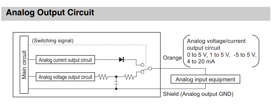

im trying to receive analog output from this keyence laser sensors and amp via arduino, but the current output is just giving me some random values not the real measurements
wiring diagram from the manual:
(link:Connection and wiring, Connection and wiring -9 | KEYENCE IL Series User Manual | Page 29 / 140)
i connected the analog pin to A0 on my arduino uno 3 board and analog shield pin to gnd, can anyone correct me if im wrong?

Do you have a link to the sensor manual.

i updated the post, could you take a look again? thanks!
Which sensor do you exactly have. Your wiring diagram shows a number of options for the output; did you configure the unit to use the correct one (you probably should use 0-5V; page 3.2 of the full manual).

i have il-1000 amplifier connected to sensor head il-s025, tysm for your help:))
