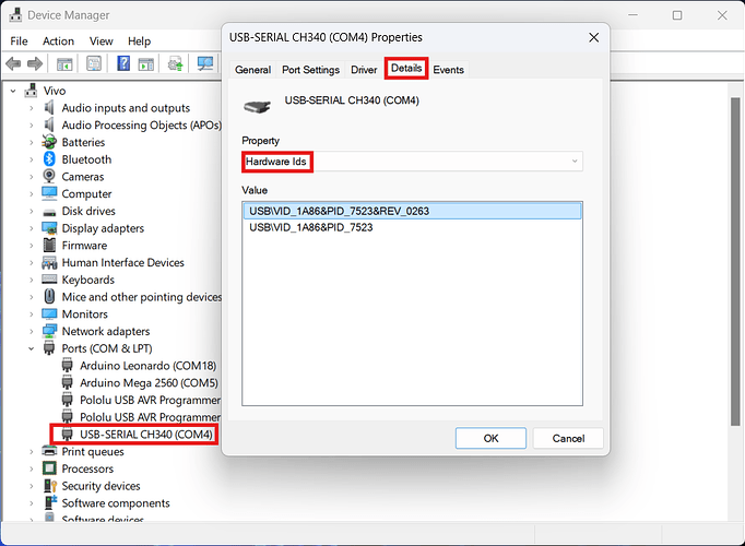

Vendor ID and Product ID.
Double click the entry in device manager, select the Details tab and select Hardware Ids from the Property drop-down.
1A86 is the vendor ID and 7523 is the product ID.

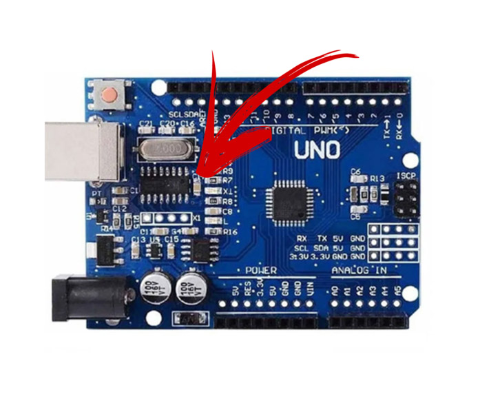

Almost all Arduino chinese clones sold here have a CH340 chip as the USB to Serial converter. This requires a specific driver.
Does your board has this chip? If you cannot identify, please send a picture of your board.

  3. Following your instructions (Details – Hardware IDs – Property) it is shown as FTDIBUS\COMPORT&VID_0403&PID_6001 Does that help with the VID and PID?

Regarding the question about a specific chip on my board, yes, it does have the component your arrow points to; it appears to be labelled C14. My board is similar but not quite the same as your picture - I'm not sure how to post my own picture yet. Immediately to the right of the main connecting port I have the oval component as in your picture, and I also have the same or similar component to the right of the square CPU and just to the left of your C6 (which I also have). Does that help? You mentioned a specific driver?

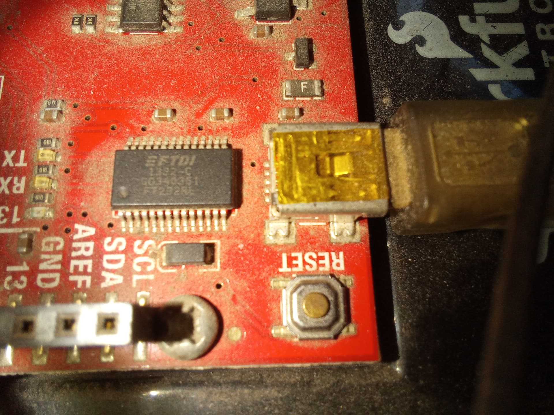

It's strange to find a cheap clone with a FT232 chip; there is nothing wrong with that (I have an expensive clone with the FT232). I don't have an official Nano so can't check the VID/PID but I'm reasonably sure that it will be the same as in your output. The chip should look like below (count the number of pins). It's also what @Brazilino pointed at, not at the small capacitor (:wink:)

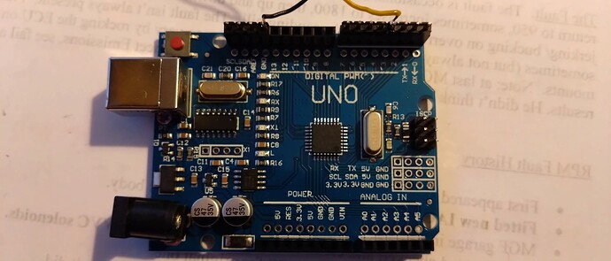

This is my arduino. Does that take us any further?
I'm trying, so far unsucessfully, to install the CH340 driver - is that the right thing to do?
Yes. It really looks like your board has a CH34x chip, which means you have to install the driver. Why it is showing as an FTDI device in COM4 remains a mistery though.

The chip in the red block below is not a FT232 as indicated by the VID/PID in Windows device manager. It looks like a CH340.
That chip is as fake as it can be. There has been one topic with the same symptoms for a Nano; Arduino nano unable to establish connection with laptop. Poor user bought it locally, went back to the shop and was told that there was no warranty on it because it was Chinese import.
It's an fake non functional Usb to serial converter.It happened to too

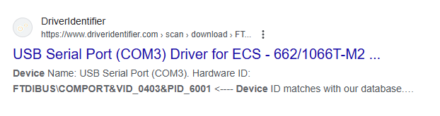

Also found a driver don t know if it will work.
https://www.driveridentifier.com/scan/usb-serial-port-com3/download/109364265/B811C45350484182B32B3E1AC4548DB9/FTDIBUS%5CCOMPORT%26VID_0403%26PID_6001
