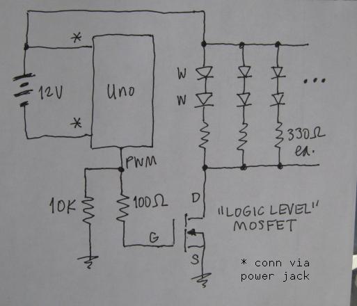

The drawing (attached) shows how I figure easiest - 2 in series with their own resistor, in parallel with all the rest, all going through the one FET, PWM-controlled, I estimate 380 mA.
(The dwg doesn’t include the flexsensor, it’s just the LEDs circuit.)
I see the sketch (programme) as a loop that’s constantly (well, repeatedly anyway) reading the flexsensor and adjusting the PWM output based on that…
And that could be fluid or coarse, depending on your vision of that action.
Good “logic level MOSFETs” are STP40NF10L or IRLZ44, both available from DigiKey.
http://www.digikey.com/product-detail/en/STP40NF10L/497-6741-5-ND/1039549
http://www.digikey.com/product-detail/en/IRLZ44NPBF/IRLZ44NPBF-ND/811808
Maybe you have other resources available. You should buy at least a couple, in case of “mishaps”.
I’ll stress that you can, and should, come up with the sketch and then implement a modest test of that - while you wait for your MOSFETs to arrive.
You don’t have to run a wire from each pair back to the MOSFET.
The pairs and resistors would be assembled in the “head” with two wires running out of it back to the “control box” (one for +12 and the other to the MOSFET’s Drain.)

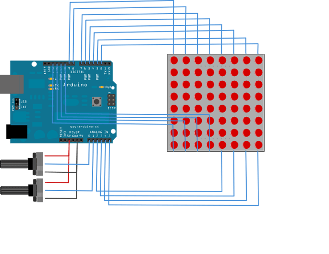

Is there any reason I can’t just do what this sketch shows? http://arduino.cc/en/Tutorial/RowColumnScanning
Picture below:
And then one of the potentiometers is the flex sensor…??

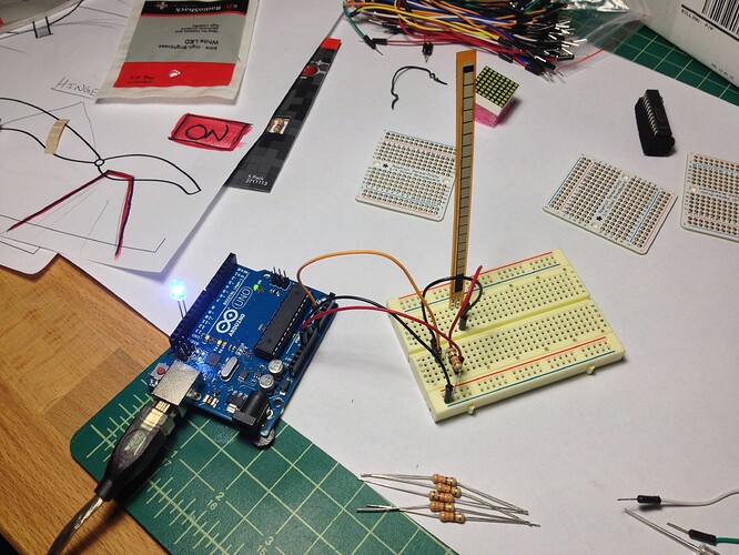

I have the flex sensor rigged up working with a single LED still mounted on the arduino uno. Code needs some revision to make it a broader dimming process but I also believe the effect will be more visible with multiple LEDs idk I may be wrong please let me know.
I got the caps and resistors-also picked up an arduino proto board and a separate larger breadboard for testing.
My vocabulary for this stuff is very minimal especially abbreviations so I guess I’m wondering if you could just draw me what you meant.

In the tutorial you've linked to the two pots are used to position a lit LED (one sets the X-axis position and the other sets the Y-axis position.)
