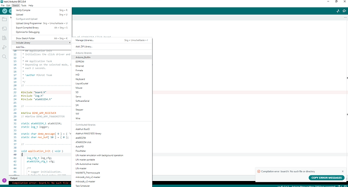

I added a library manually to my sketchbook, it shows in the included library list but ti's still not working. I'm sure the file 'board,h' is in the library. What could possibly be the problem? Thank you.
The library name is the 'mikrosdk_v2-master'
libraries have nothing to do with tools or boards

Hi @rootspapapa. First of all I think it will be important for you to provide more information:
Please provide a link to where you found the code that includes the #include
directive for boards.h
Please tell us what made you think you needed to install this "mikrosdk_v2-master" library. If you are following some instructions, please provide a link to them.
I'm not implying that you are necessarily in error in these things. We simply need more information to understand the situation.

When you compile a sketch, Arduino IDE does a process referred to as "library discovery", where the installed libraries are searched for any header files in the #include
directives of the sketch code which were not found by the compiler in its include search paths. Once discovered, the library's path is added to the compiler's include search paths.
Only the files in the root of the library's source folder searched during library discovery.
Once the library's path has been added to the compiler's include search path, it is then possible to include additional header files from subfolders by using the file's path relative to the root of the source folder in the #include
directive.

From the path shown in the File Explorer screenshot you shared, it is clear the file board.h
is not in the root of the source folder:
so a "board.h: No such file or directory
" error message is normal and expected for an #include
directive like:
#include <board.h>

This is the library i first want to use, and i find it unable to upload the zip file as a library, so i added the file manually by adding the file of it into the 'library' in my sketchbook. And then this seems to worked. But the examples in this library uses 3 other libraries,
Other mikroE Libraries used in the example:
That isn't an Arduino Library. You can learn about mikroSDK here:
