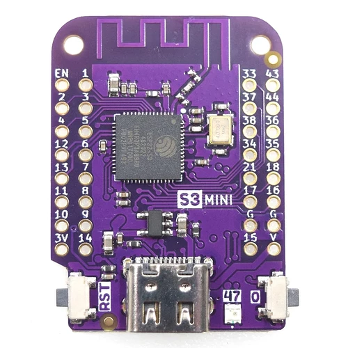

How would you recommend I breadbord this? I know, i feel like an idiot...is there a trick?
Do you need all the pins?
I dont ...but if i needed to use two adjacent pins for some reason how would I do it?
Thanks?
Solder header pins to this PCB (not necessarily all) and then run jumpers to your breadboard as needed.
two rows pinheader at bottom and two on the top
What kind of breadboard? Are you talking about the plug in stripboards? By the way, the outer rows are essentially plug compatible with the D1 Mini series expander and modules. So the most common connections, like TX/RX, power, I2C are all on those...
The underside of some of my breadboards have removable jumper clips "under" the bottom layer of adhered plastic on the rows pins, which, when removed, "open" the pin row for side-by-side pins. I do not know if the pin spacing will allow for this S3mini.
Thanks all! I am used to using bottom headers and then connecting from the pin rows - using headers on the top and jumpers seems to be the concensus. I don't know why I didn't think of that! Appreciate the help!
