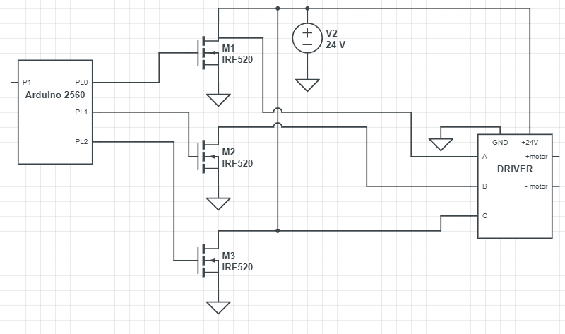

actually my connection (that do not work) is:
arduino pin PL0 -> IRF-gate
IRF-collector -> +24V -> Driver-PIN-A
IRF-drain -> GND (also common to Driver)
Same for arduino pins PL1 and PL2 with Pin B and C
When PL0 is ON, all Pin A B C get +24V
(see attached schema)
so i tought i need a P-Channel, or to connect the N-channel in a way i dont know....
any help appreciated.
thanks

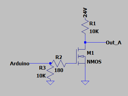

Your circuit is lacking a load or pullup resistor, and you need two gate resistors. A typical circuit is shown below. A HIGH on the Arduino output will drive Out_A LOW.

great! thanks much! except for the resistors this is how i intended to connect...
but the problem is that having 3 repetitions of your schema, when i turn ON the PIN A, also B and C get turned ON. i suppose this is because (not too obviously for me) the GND of the drivers is common to all PINS, so when NMOS of PinA conduct, the same GND conduct for Pin B and C ...
i'm sorry, really don't know if you can understand me... it's difficoult to explain for a non-professional like me.
All three resistors are required.
Sorry, your explanation makes no sense. The grounds all have to be connected for that circuit to work, and for 3x the above, you will need 9 resistors and 3 MOSFETs. The A,B,C driver inputs will all be independently controlled.
If you don't want to connect the grounds of the Arduino and the motor driver/motor power supply, you MUST use three optoisolators, as MarkT suggested above.

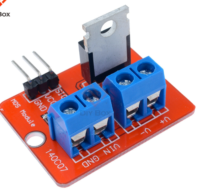

first, i'm using the module in the pic attached (i think resistors alre already setup on the module)
second, i want to connect all GND in common, and is for this that pin-a and pin-b get ON at same time.
from the CABLE of the drivers i have 4 WIRES. A B C and GND, so for each PIN the GND is common. (i linked this GND to Arduino-GND)
see the attached pic. as the 24V are EVER connected and conducting to PinA and PinB, when the NMOS on top conducts, the GND is conducting also for PinB ...(because GND are common).
i tried putting some LED on PinA and PinB, and when i fire Gate on ONE NMOS, both led have light....
i'm just wondering if the problem is that i should add ADDITIVE resistors OUT of the module as you shown.

The picture of the MOSFET module is completely useless. Please post a link to the module product page or data sheet.
jremington:
ok, i' tought it was a famous module... searching "irf arduino" on google: half results and pictures have this module
see attached image. (sorry i don't know how to show the picture in the text directly)
The module design is terrible, why should it be "famous"? It lacks the two most important resistors, R1 and R2 shown in the circuit diagram I posted. I recommend throwing those in the trash bin and buying optocouplers.
R2 in the circuit I posted is required to limit the gate current and if it is missing, you will eventually damage the Arduino, by drawing too much current from the port pin (charging and discharging the gate capacitance).
Read this application note. Get familiar with MOSFETs and how they work. When considering a switching device learn how to make a well informed decision. Everything we see on the internet is not fact and every module fresh off the boat is not a solution. You don't learn to swim in the deep end of the pool.
Ron

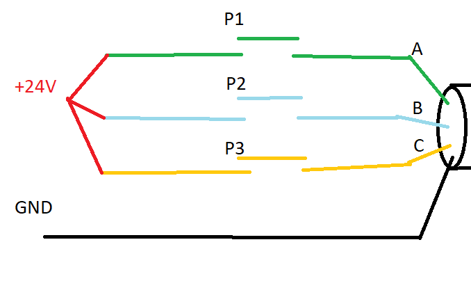

Let's suppose for a moment that we have ideal digital n-mosfet and that we could imagine those as little remote digital interruptor.
i have to leave the +24V signal pass into 3 wires, A B C, that have a common GND (cable of 4 wires). max wire consumption is 10mA for each.
(ignore for a moment missing resistor that could damage arduino, i say let's ignore for a moment the arduino existance).
I'm trying to connect this 3 wires to the 3 IRF520 modules as for my previous schema of the module.
I'm connecting:
+24V to VIN of each module
A-B-C to V+ of each module
GND of the 4-wires-CABLE to V- of each module
and indipendent +5V signal to each SIG pin of each module
GND to GND-pin near SIG of each module
What it happens now (tested on circuit with LEDs): [*** THIS IS MY PROBLEM ***]
when i activate +5V Signal to module of PIN A, also B and C have a +24V between V+ and V- .
I want to pilot each signal indipendently from the other.
WHY this happens? (i think) it's because A B C are directly connected to +24V (see the V+ of the module) and when N-Mosfet of Module-A conducts, it is giving the pass to GND for all other Modules (because the GND of 4-wires cable is common to all A B C).
So this is a WIRING/Schema/Circuit problem that i would have also with normal switch push-buttons. is not related to specific mosfet.
What i'm asking to you?
Is there a way to connect the module (or any optimum n-MOSFET) in a way that i could control each PIN indipendently?
To put SIMPLIER and to not disguise who want to try help me,
here is what i want to obtain.
Tha AIM is replace P1 P2 and P3 with a N-MOSFET activated by indipendent signal of +5V
Hope the problem is much clearer now and that someone could help me.

This wont work for my project because i need a positive logic. I need " A HIGH on the Arduino output will drive Out_A HIGH (not LOW)." because elseway when Arduino start Out_A will be HIGH by default and the motor will start for a moment til arduino output a LOW...
Go back and look at Jremington's Post #7 drawing. You are using an N channel mosfet. You want low side switching meaning you switch the - (negative) side of each load to ground. Make it like the drawing in post #7.

Ron i really thank you for your attempt to help me, but it seems i cannot explain well the problem or you are not reading my request.
you say "You want low side switching" but this is not what i want.
I need to send +24V signals on ABC pins of external driver ONLY WHEN Arduino set that ports to HIGH - not anything similar. From what you are saying I'm supposing a N-mosfet is not what i should use for this... maybe i should use a P-mosfet? then just advice it me and maybe write a model number so i can study/buy it.
I already tested the Jremington's Post #7 drawing (except for R1 and R2) and as you can read in my post #16 it is not working as expected as giving HIGH on ONE only GATE of the 3 mosfet, all ABC output go HIGH.
I'm wondering if an optoisolator like PC817 (i have a board with 4 of it mounted on) could solve my problems. it seems the PC817 may support 3-24V both on input and output... for 10mA it could be the best solutions.
What you think about it?
