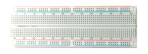

A word of warning. Some breadboards have a break in the sets of sockets along their edges, like this
It is easy to be caught out and try to input power at one end and use it at the other end without bridging the gap in the centre
