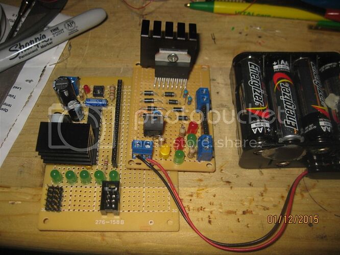

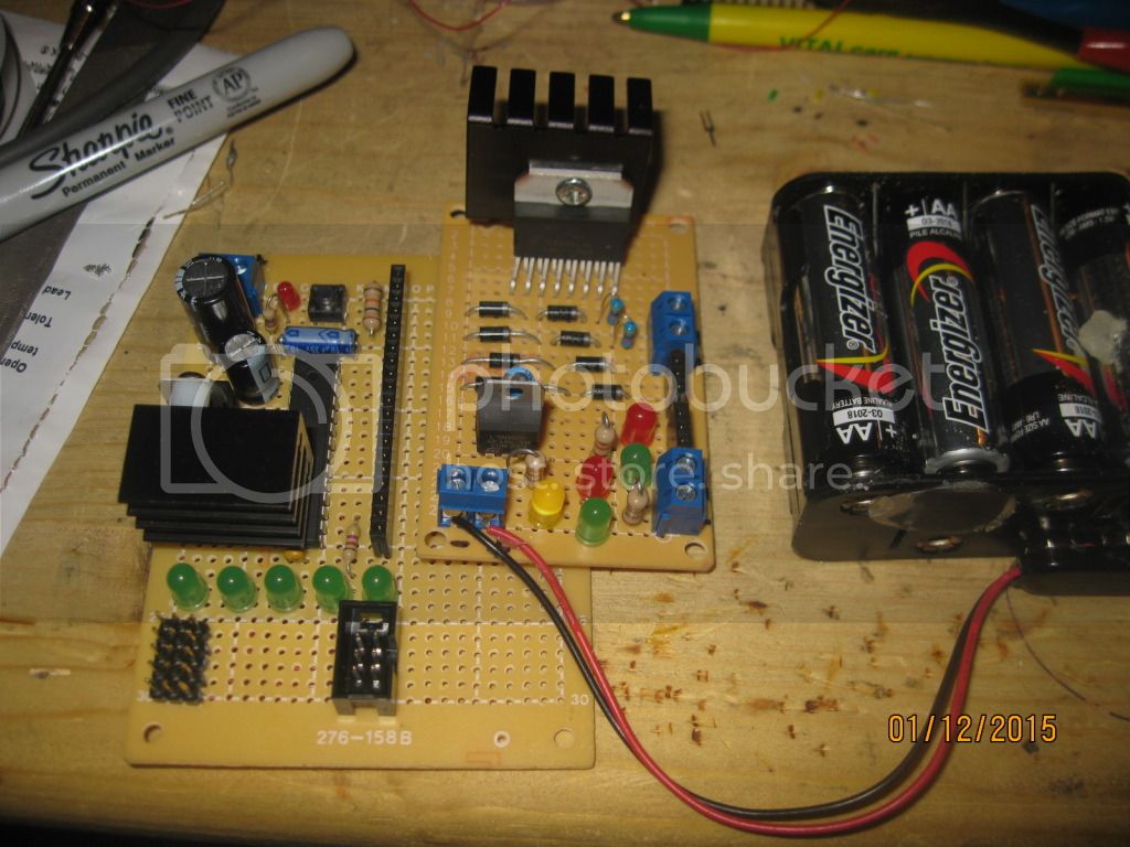

Thanks for all the input! I got my parts in and built this:
It's basically this: http://www.solarbotics.com/product/k_cmd/
Schematic: http://content.solarbotics.com/products/schematics/solarbotics-l298_schematic_complete.jpg
I'm a little confused about the 7805 though. Does the 5V from the regulator go to the pin marked 5V on the chip? There is no trace on the schematic to it.
Plus any advise on making this thing work with my Arduino would be most welcome!
Yes, pin 9 of the L298N should go to the +5v output from the regulator. Alternatively, connect pin 9 to the +5v supply of the Arduino that your board is connected to, then the regulator is redundant.
PS - you should also have a capacitor of several 100s or 1000s of uF connected between pin 4 (+) and the ground pins (-) of the L298N.
If you google for "Arduino l298n" you will finds lots of matches.
Thanks. I implemented the changes you recommended. One thing I noticed was that one of the leds wired to the motor lugs illuminated once I hooked the 5V from the regulator up.
I loaded a sketch and got some blinky action but I think I'm confused about interfacing the Arduino with the controller. The controller has these inputs from the Arduino:

hoff70:
That suggests you have a short somewhere, or one of the diodes is connected the wrong way round. Fix that before you try driving it from the Arduino, or you may burn out the L298.
Thanks. I went over everything with a meter starting at pin 1 and tracing each wire. I was getting discouraged when I was up to 11 or so and didn't spot any problems.
By the way, pin 15 is supposed to be connected to ground :roll_eyes:
It works!
Now to figure out how to make it control even bigger motors. Relays, MOSFETS?
