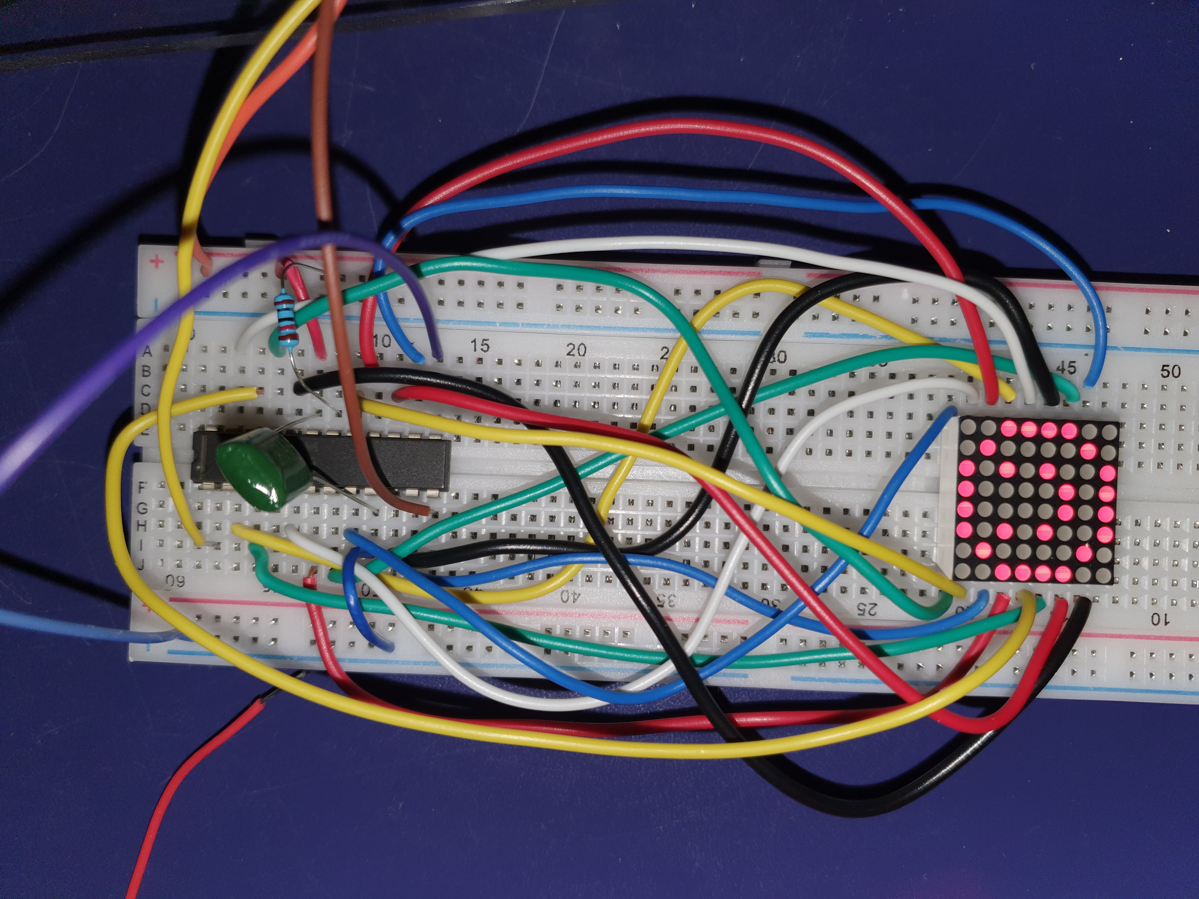

Here is the image of the wiring.
A bit messy with long wires - so that the wiring is more easy to follow.
Full scale image
A bit messy
An understatement! :wink:
This is exactly my point. With wiring this messy you can check the connections until the cows come home and will miss an error.
I use solid core wire when building breadboard prototypes, cut to length and laid flat against the breadboard.
I agree, but in this case following the wires would be more difficult having only one prototype board available.
Using different colors do help a bit.

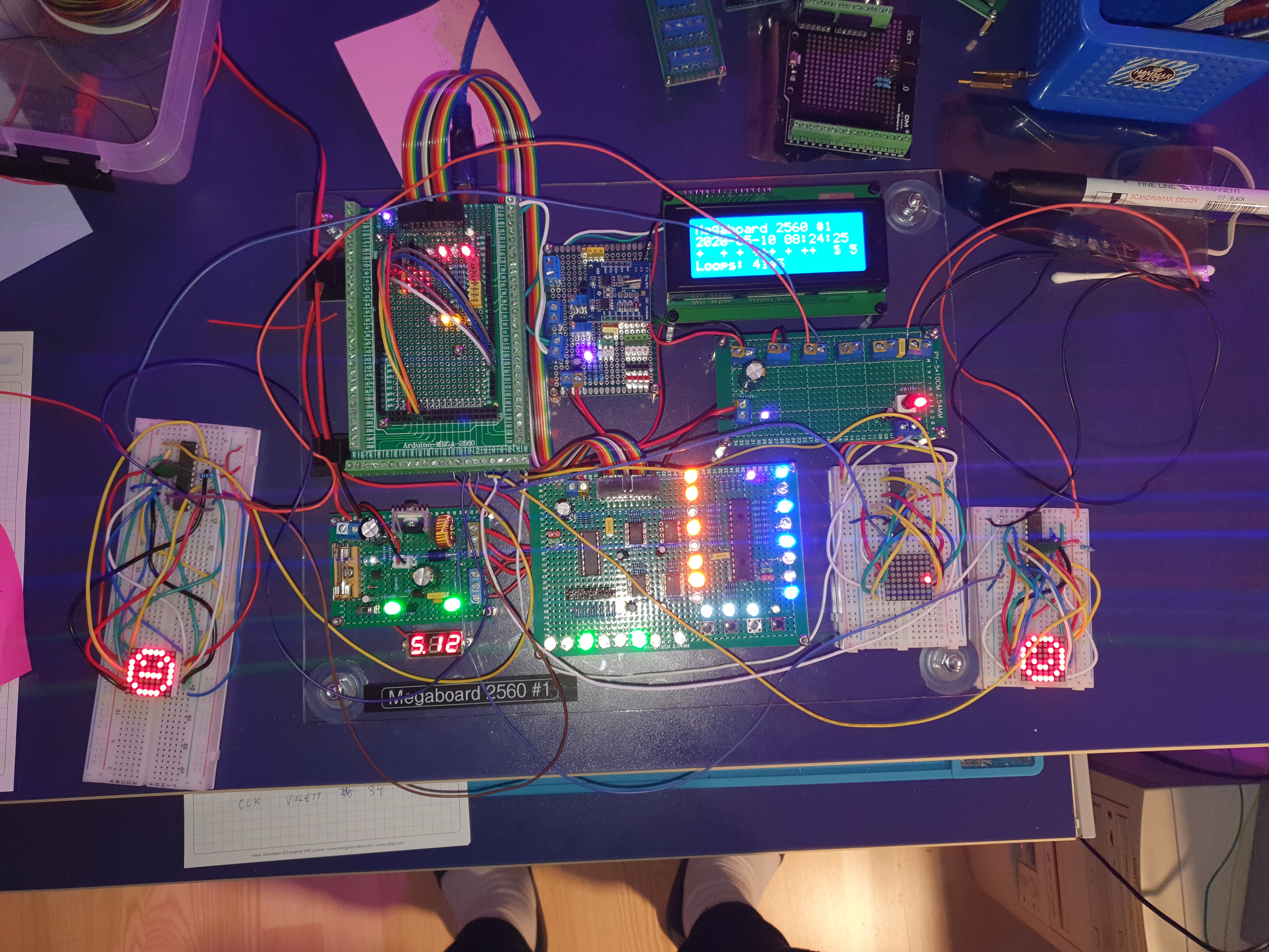

BTW, image of the complete setup showing all three 7219+led matrix units plus a bit more :slight_smile:
I already got that information :slight_smile:
Why do five different attempts give the same result? And why do the minor modification in SW (done by the derived class MyLedControl) fix this? The wiring cannot be completely wrong, can it?
