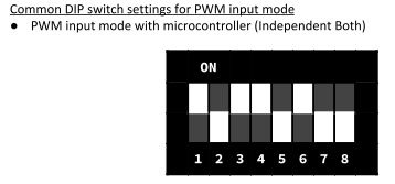

Hey! need some help to wire my arduino to this setup using pwm, how should i wire everything related to Arduino card from this motordriver? hard to find help about this specific motordriver.. ![]()
A quick look at the page you links and they link Arduino examples here and a user manual that shows how to wire it up and set jumper settings.
Ye, i can't really find the wiring scheme tho, could u help me?...
Assuming your using the Arduino UNO then...
For PWM you need to use the 2 grove connectors (N and O on the board image below)
Connector N is marked AN2, AN1, NC & GND
AN2 is the PWM input for right motor (Arduino pin 9)
AN1 is the PWM input for the left motor (Arduino pin 3)
NC is not connected (NC = No Connection)
GND is for connecting to the Arduino GND
Connector O is marked IN2, IN1, NC & GND
IN2 is the motor direction for the right motor (Arduino pin 10)
IN1 is the motor direction for the left motor (Arduino pin 4)
The manual shows the DIP switch settings needed for PWM but I have included the DIP image for completeness.
If you connect this like this then the PWM_DIR_DUAL.ino example from the Cytron github site I linked (Included below) should work.

I am working / learning to combine Mdds30 motordriver and Adruino Nano and controlling the speed and direction with a analog Joystick.
I got it so far that the motors are working independent on x axis and one on y axis.
I want to have both motors going forward and backwards on one axis.
I done it with a different motor-driver, but can’t figure it out using Cytron MDDS30.
Could anybody give me some advice or help me with the code.
Basically it would be the same idea as driving a wheelchair.
Thank you

Hello Carneym1982
I looked over the sketch and I don’t think it will work.
The mdds30 has only 4 inputs AN1 and AN2 and also In1 and In2.
I am using right now AN1 andAn2 connected to the Joystick. But I would like also connect 3 push buttons to simulate the Joystick.
Where the push buttons only have one preset speed .
Hi there, Could you connect the push buttons to open pins on the Arduino?
I think that's how I would set it up.
