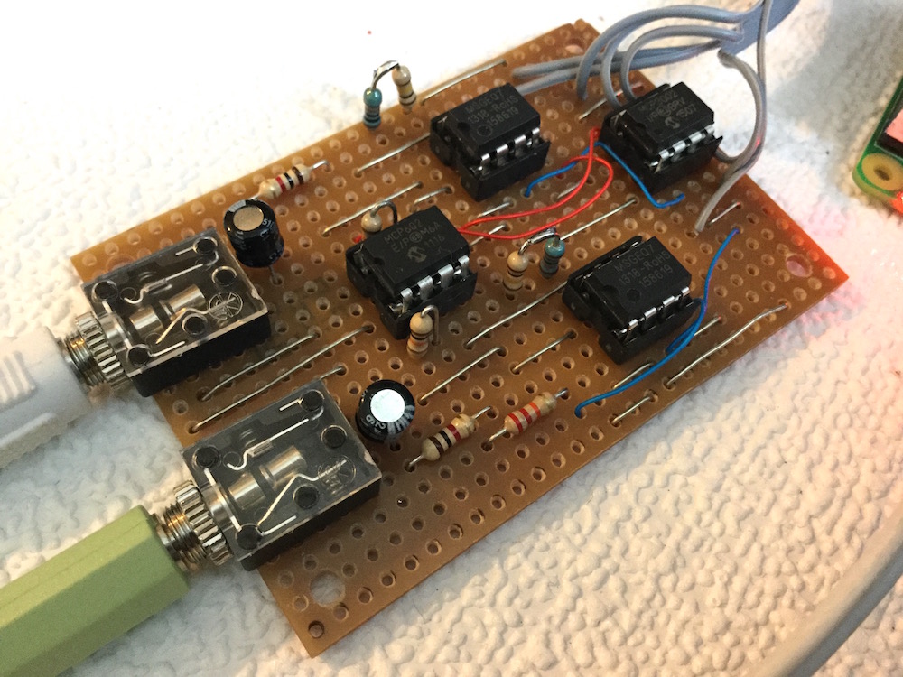

I have some MSGEQ7 bare IC chips. I have one on a breadboard working just fine with 7 LEDs to the 7 frequency bands doing PWM to audio headphone level input. Both left and right channel from the source are connected to the input pin of the chip, so there's no stereo distinction.
I'm planning on putting two of them on perf board for a semi permanent rig. One chip for each channel.
I'm wondering which components/aspects can be shared between the two chips.
For example, can they/should they both share the same Strobe and Reset pins from the Arduino, or do they each need their own?
Would they each need their own decoupling capacitors or can they just share one? Would the value of a shared one need to change when going to two chips?
I've never used the MSGEQ7 but I believe you can share the strobe & reset pins. (There is a timing diagram at the bottom of the datasheet.)
The general rule with digital and analog chips, is that every chip has a it's own bypass cap, mounted as close as possible to the chip's Vcc and ground pins And if the chip has more than one power-pin, each power-pin should have a capacitor. (Usually a PC board will work with a missing bypass cap or two, but if you want a reliable circuit follow the recommendations.)

This is a project I did earlier this year. Here is the schematic:-
The amplifier allows for a smaller audio input than an iPad at full blast. Note the way the virtual ground from each MSEQ is used for each side's amplifiers.
Note it was for a system without any built in A/D, you can miss that out and feed the analogue outputs directly into the Arduino.
This is what it looked like:-
This is what I did with it:-
I have noticed the rather insensitive MSGEQ7, level mismatch where the input has to be rather loud to fit nicely into the output display. I was considering using a pot to adjust values with coding (mathematically boosting the readings and just dealing with the smaller readings), but it might be under the realm of what the MSGEQ7 detects.
A gain pot is something I'm figuring out. Leave the passthrough level unaffected, just be able to adjust the output. But of course pots don't amplify, so I need to over-amp it a touch to give a usable range of attenuation. I'll have to look up those chips you used. I assume those are what's doing the signal amplification.
It's the MCP602 which has two op-amps in one package.

But - the input to the MSGEQ7 is a high impedance so you are after a voltage gain. Note that circuit I posted worked from a 3V3 supply. It is better from a 5V supply but you need more voltage on the input to get the outputs higher.
I found that without the amplifier the input volume had to be too high. Yes you could cut down the through audio signal with a pot but for balance it would have to be a two ganged pot. And you also run the risk of not having enough input voltage from your input source.

Would the LM358 work just the same as the MCP602?
INTP:
It is not as good at working at a low voltage and the output can't get as close to the rail.
