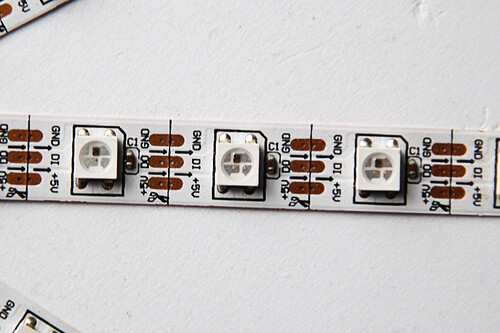

I have a problem with a led strip, I want to cut it in 3 pieces and weld them together with electric wire and put them in one of my shelf, so I weld them together and fix the weld with my glue gun, with that I'm sure that none of my weld will break and it work fine and all the led are lighting up I use a very basic code that just light up the led in white color. (I use this strip because it's an extra from a previous project)
but, here's my problem, the last strip just don't light up when I turn on the whole set, but, the strange thing here and the reason why I'm writing here is: when I hit the strip with my finger it just light up but with some very random and unwanted effect (some led light up and other just don't, they sometimes light up with a bad color) and when I hit it again the effect change. and when I update my code via Arduino the first 2 strip are updated correctly but the last one just don't do anything.
I don't think it's because of my welding because the led are lighting up good (they don't blink or anything) but it can be a part of the problem, I'm not a pro in this domain.
Maybe the strip is just broke and there is nothing to do but I want to search for a solution first.
Do you know if there is a way to put back this rebel strip into the right path?

Check the data line. If the power lines are good but the data line has a bad connection it could cause the issue because they're getting power but not clean control signals.

If they are addressable RGB also check which way round the data line is on the "bad" strip.

There is usually a small arrow on the data line near the cut points that shows the direction towards the END.
Make sure that is pointing AWAY from the arduino.
Yep it's pointing in the right direction.

However I would say that your origional problem is faulty wiring.
