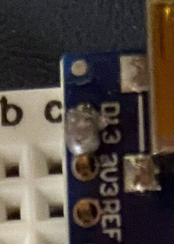

Im trying to move my build to a nano instead of an uno but have some issues. I got over all the driver set up to work with the IDE and got the built in LED to blink. When I try doing the same with a different LED - it doesn’t work and I am clueless :\ tried an online search but couldn’t find an answer so figured I could use the help here :slight_smile: TIA! :slight_smile:
  pinMode(3, OUTPUT);
  digitalWrite(3, HIGH);
  digitalWrite(3, LOW);

just a doubt: it seems you did not solder all the headers.... can you confirm?
the D3 and GND pins need to be soldered (at minimum)
(and there is a suspicious soldering job at pin D13 which appears to touch the 3.3V pin)
you are correct, I did not solder it all. Is that something that has to be done in order for it to work?
again, newbie here :slight_smile: I tried with a different nano that's also not soldered (not even a few pins).

It would have been bad if you set D13 as output and LOW because then you would have had a direct connexion from 3.3V to ground - a short circuit.
Pins are set as INPUT (high impedance) by default so probably OK if you did not do anything with that pin - just remove the D13 soldering that is touching 3.3V and start again

no luck... could it be that the soldering job is so poor it didnt help?
is it a fair assumption to think that if i had damaged the board, the power light would not turn on?
One leg of the resistor for the led needs to plug into row 11 where the red wire goes. See this tutorial for what holes in the breadboard are connected to others.
