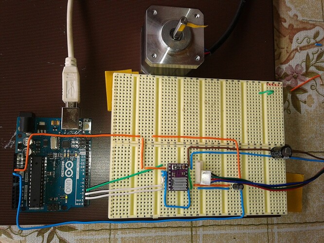

Running the code, stepper shaft become stiff but not moving at all. A small intensity noise is coming from inside as similar as is rotating but only noise. DRV cooler is enough hot but still I can keep my finger on top for 3-4 seconds.
I've done current adjustment according instructions from above guide.I'm not sure if connection between two GND is necessary (Arduino and power GNDs; small green wire ). Powering done with 12V, 2A DC adapter.
Thank you if somebody can help me.

However I think my problem is coming from wiring or from current settings.Here I have to find my mistake.
I managed to make stepper to move following producer web page and
by proper adjustment the of current and by reducing wiring to minimum.
Stepper is moving but is a very chaotic movement.Steps forward,backward or no step in the same loop.
For example using code below, stepper is doing sometimes one revolution CW sometimes not.Even if it is a full revolution the steps are alternating forward/backward.And not all the times is a full revolution. Sometime is more sometime less.
In the second part of the code, when the rotation suppose to be in opposite direction, stepper is nothing doing.
Using micro-stepping movement seems to improve but is far from a smooth one.

What power supply are you using for the motor (volts and amps) ?
Yes Robin, I tried with the same inconsistent and chaotic movement result.
I'm using a 12V 2A AC/DC adapter. I didn't checked its performance (because I don't know how) but I'll try to find a better/bigger one this days.

LE. I solved the problem. Doing so many attempts I forgot to connect the two GND each other (power and Arduino). Now your code is working fine.
Thank you for your help.
