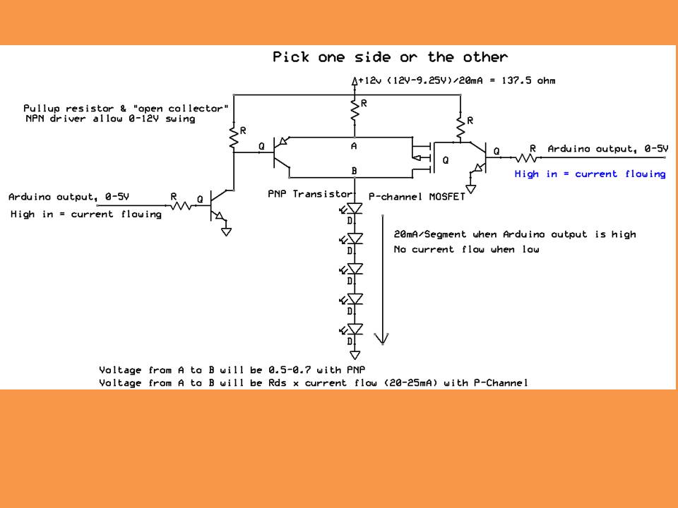

Need to drive three of these with Arduino: Single Hi-Red 4.0 inch CC 7-Seg LED Display Data
I'm thinking use a transistor to convert the Arduino's 5V output to a 10V @ 25mA output going to each display segment. Vs will be 12 volts, so 400 ohm resistor on the Vs line I figure?
I thinking connect digital pin to base, Vs power line to collector, and the LED segment to emitter.
But for 14 segments, it would be better if I could use a couple of IC's versus 14 transistors. Do these exist? The closest I can find is a common-emitter 8x darlington, http://www.mouser.com/ProductDetail/STMicroelectronics/ULN2803A/?qs=sGAEpiMZZMutXGli8Ay4kAHmCxIxFTXSfbpCT5ik4XI%3D
It's a common cathode so that makes it harder to drive.
You need to look for a high sided driver like the Allegro 2981

You would need to do it like this:

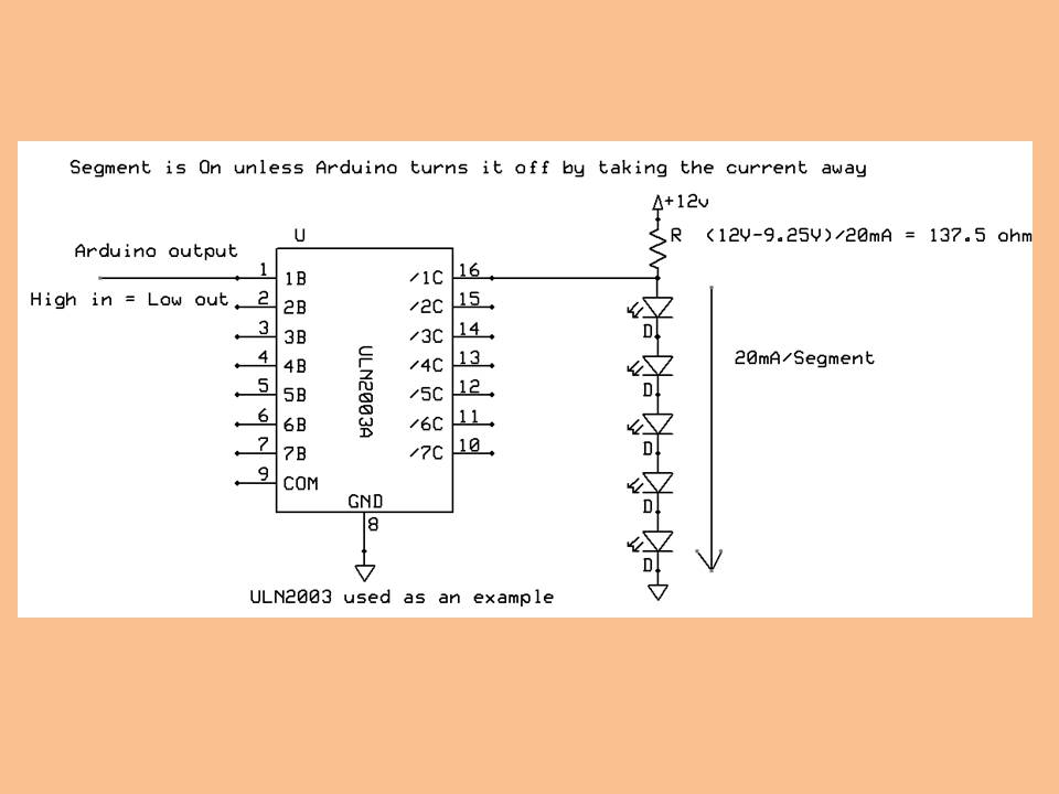

What makes a CC harder to drive than a CA?
Because with a common anode all you have to do is to pull down to ground with a transistor or transistor array, these are quite common and cheap as you have found.
With common cathode you have to have a source of voltage generated from the arduino. As this is a much rarer situation and needs more electronics to achieve these are more expensive.
Many beginners are in the mindset that common cathode is the sensible straightforward thing to have, in this they are mistaken.
CrossRoads circuit technique is called shunt switching, and consumes more power when the LEDs are off than when they are on.

The ULN2003 is 67 cents at mouser for 7 array, the ULN2803 is $1 at mouser for 8 array.
It takes more current because having the arduino output turned on is what turns off the LED segmant?
How many mA are we talking about? This is going on a 12V/1A power brick with voltage regulators so I think I would be fine.
So if I understand that, the darlington array "steals" the ground and re-routes it around the LED segment, so it does not light? Arduino 5V signal goes to base, LED Vs goes to collector, and emitter goes to ground.
Yes.
Yes the darlington shorts out the LEDs.
When the LEDs are on there is 20mA going through them. But when the LEDs are off there is:-
12 / 137.5 = 87.2 mA going through the darlington, and it is burning 12 X 0.0872 = 1.05 Watts, so it needs to be a big resistor.

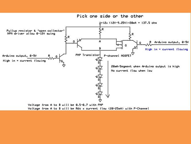

The other option is to put a PNP transistor, or P-Channel MOSFET, between +12V and the individual segment Anodes,
i.e. "roll your own" driver.
The Allegro 2981 part does that in an array of 8 drivers; unfortunately it has a 1.8V drop from +12V to the output.

The darlington can handle that much current, yes?
Yes they can take 500mA each with a total per package not exceeding about 650mA.
