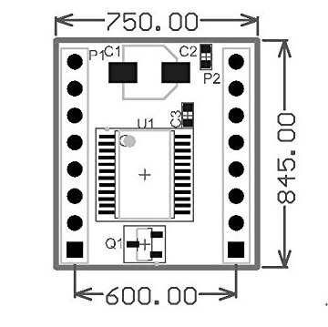

Yes. See application circuit in datasheet. They show 0.1uf and a larger cap on both Vcc and VM - note that your breakout board will at least include the 0.1uf caps on it if you get a commercial TB6612 breakout board.
Yes, as noted above.
Nope, it's got internal ones, per datasheet.
Drive STBY low before going into sleep, per datasheet consumption should be 1uA while STBY is low.

It's a commercial one, yes, this is the layout (it's a cheap one with no documentation :S): https://images-na.ssl-images-amazon.com/images/I/41XE0GcMa3L.jpg (https://www.amazon.co.uk/TB6612FNG-Motor-Driver-Module-Arduino/dp/B017347VXO)
Comparing with the Pololu product (Pololu - TB6612FNG Dual Motor Driver Carrier), I think the one I bought has C1, C2 and C3. The datasheet typical application schema (https://www.pololu.com/file/0J86/TB6612FNG.pdf, page 7) does not include Pololu's C4 (a 3rd capacitor at VM), but has two capacitors for VCC as you mention.
Seeing the sizes of the components in the picture of the circuit I bought, I'm guessing that only the 10uF at VCC is missing.
One question: I was thinking of using one 0.1uF capacitor for each of the voltage input in the Atmega328 (VCC/GND and AVCC/GND). Does the TB6612FNG require more capacitors at VCC?
