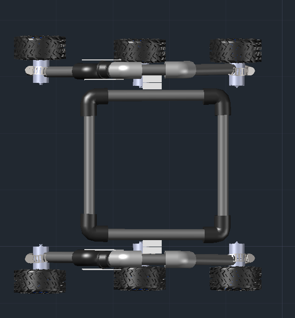

Hello everyone,
I'm working on a summer project provided by my school.
I want to build a 6 wheeled rover made of PVC pipes.
I will use six 12V DC Motors.
I'm a young Mechanical Engineer major, so I don't have too much experience with engineering hands on!
From my research, I believe using the L298N Driver is ideal for my project.
From my understanding, I will need three L298N Drivers, one L298N Driver for two DC Motors.
Is this correct?
Also I have an Arduino Uno but can get another Arduino if needed.
However I noticed that the Arduino can only support up to two L298N Drivers due to having two Ground ports, meaning I can only control 4 wheels?
I looked at many videos but only saw videos of 4 or 2 wheeled cars.
I'm not sure how to add more Ground ports unless I use the bread board but I don't have enough knowledge to really know how to utilize it.
Once I finish installing the wheels, I want to add wireless control to move the rover.
Then add in the Temperature and Humidity Sensor.
I added these additions to the topic to see if I can do it all in my Arduino Uno or if I need to upgrade to the Arduino Mega or of some sorts.
Thank you all!
EDIT:
I have attached screenshots of a 3D model I pieced together on how I visualize the Rover:
(I used premade pipe models, motor models, etc. I just pieced it together in Autocad.)
As the Arduino ground connections are basically for signal ground, you can connect as many wires to the grounds as you need. Use stranded wire and wire nuts to connect the various wires together. If you don't like wire nuts, then solder the wires together.
How heavy? What batteries? What terrain? I'd go with a more robust, off the shelf motor driver set, honestly. You want to build something reliable? IMO, using L298N is asking for failure with motors that size for any actual practical purpose. 2A continuous per channel? At least that's what my cursory search turned up, maybe I'm wrong.
In bots I've built, I'd start at 25A per channel.

Well, it's "supposed" to be a rover for Mars so I would say in rocky terrains, dry flooring with possible holes and cracks. But nothing crazy, I will just have it drive on garden soil, the beach, small back yard decorative pebbles.
My program said it doesn't have to be all the way authentic so it can be kinda like a hobbyist rover, since I'm just supposed to learn how to use arduino and have it interact with the hardware.
So it doesn't have to be too real, just make it work, haha.
I'm going with something like this with a similar size: How to Make a Mars Rover / Rocker bogie Robot - Stair climbing - YouTube
Here is his material list: Rocker bogie robot
I'm sure I'm headed for disaster, so I want to make it at least not blow up on my face.

I suggest you consider the TB6612FNG instead of the L298. It's a much newer device with much better output drive characteristics.
Physical wiring will be critical. You should make a single connection point for common (aka ground). Connect ALL your grounds to this one point. Keep the Arduino leads short (near the common point). This type of connection is referred to a "Star" grounding approach.
You should also keep the wires going to the motors physically away from the low signal wires of the Arduino. This will reduce the propensity of the motor generated electrical noise from effecting the Arduino operation.
Also, don't forget your fuses/circuit breakers.

Almost certainly not. The ancient, inefficient L298 can handle at most 1 Ampere per channel, wasting approximately 1/3 of the 12V battery energy as heat in the process.
Pololu has an excellent selection of modern, efficient motor drivers. Pick one that can handle the total stall current (look it up) of your motors.

Might do. I used this driver, and their T Rex in a 50 pound build. One melted, the other exploded, but I build heavy so watch the weight.
https://www.tme.eu/en/details/dagu-rs003b34/frames-and-chassis/pololu/dagu-wild-thumper-6wd-black-34-1/
The link points to a robot chassis.
Pololu's motor drivers are remarkably well protected from meltdown, which suggests to me that you violated the driver specs (voltage supply too high, for example).
