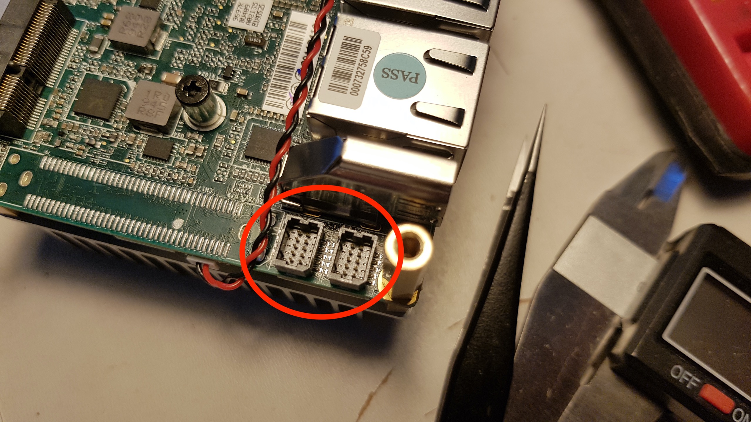

I have a AEEON PICO-KBU4 pico-itx board. The 2x5 connector you see below is meant to break out to Front Panel (ie. power button, reset button, hd activity led etc) so you can understand I want to use it! The manual says that the pairing connector for this connector is a "JCTC 11002H00-2x5P" but I can't for the life of me find anything useful about it online. The pitch is 0.80mm x 1.20mm.
Does anyone recognize this connector?

I think these are the correct specs for the socket and plug, found on the JCTC website:
Sourcing the plugs may be difficult for an individual consumer. I would start by contacting aaeon and asking them how to obtain a cable. If they are flogging the boards then they should also be making the accessories available, or should at least be able to point you in the right direction.
I was slightly enraged that you managed to find that on their website while I spent a copious amount of time 'next'-ing through their products page. Probably scrolled past this product and didn't recognize it
But yes... this does appear to be that connector. And I agree that it's probably easiest to ask the AAEON people about it.
