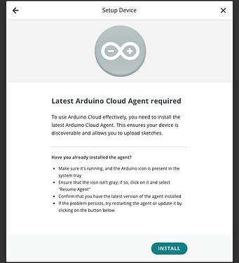

So, I was trying at the Arduino Cloud ( of course after login in ) to add device which is board - NANO 33 IOT.
  1. At the Setup Device tab I chose Arduino board
2 At the screen appeared information “ Connect your IOT device to the computer” and a little bit later “ waiting for your device to become available “
3 As the result appeared page as at screenshot:
Screen _1
I have already Agent installed and it is present at the system bar.
Icon s not gray
I do not know if this is atest Agent version - my version is : 1.2.7-ventura-df758

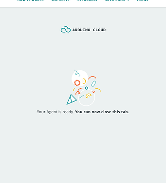

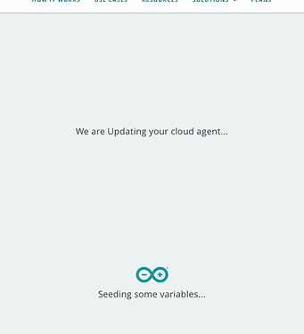

  1. As problem persist was trying update the one clicking at the green button “Install”
5 The new tab appeared :
Screen _2
And finally
Screen _3
  1. After that I closed the tab but as I was trying to add my board to the cloud situation repeated.

Thanks. That makes things more clear to me. For the benefit of others who might read this topic, I'll post the images directly here on the forum so they aren't forced to download the PDFs just to look at them:
The image from Screen _1.pdf:
The image from Screen _2.pdf:
The image from Screen _3.pdf:
I'll provide instructions you can follow to update from Arduino Create Agent 1.2.7 to 1.3.5:
A. Uninstall Arduino Create Agent 1.2.7
  1. If you see the Arduino Create Agent icon on the macOS "menu bar", control click on it and select Quit Agent from the menu.
  2. Open macOS Finder.
  3. Select Go > Go to Folder from the Arduino IDE menus.
    The "Go to Folder" dialog will open.
  4. Type ~/Applications into the "Go to Folder" field in the dialog.
  5. You will see an item "Users > <username> > Applications" (where <username> is your macOS username) in the search results. Double click on it.
    The Applications folder will open in Finder.
  6. You will see a folder named ArduinoCreateAgent in the folder listing. Control click on the ArduinoCreateAgent folder.
    A context menu will open.
  7. Select "Move to Trash" from the context menu.
    The ArduinoCreateAgent folder will disappear.
B. Install Arduino Create Agent 1.3.5
  1. Start the "SET UP NEW DEVICE" process again in Arduino Cloud, just as you did before.
  2. When you get to the "Download started Once the download has finished, install the Agent following these steps: ..." page, a download of ArduinoCreateAgent-1.3.5-osx-amd64-installer.dmg should start. If it doesn't, check the address bar in Safari. You will see an icon that looks like two overlapping dialogs:
    Click on that icon and then confirm that the download should be allowed.
  3. Wait for the download to finish.
  4. Control click the downloaded ArduinoCreateAgent-1.3.5-osx-amd64-installer.dmg file.
    An "ArduinoCreateAgent" window will open.
  5. Click and drag the "ArduinoCreateAgent" icon to the "Applications" folder icon in the "ArduinoCreateAgent" window.
  6. Open the macOS Launchpad.
  7. You should see an "ArduinoCreateAgent" app in the Launchpad window. Click on it.
  8. A ""ArduinoCreateAgent" is an app downloaded from the Internet. Are you sure you want to open it?" dialog might now appear. If so, click the "Open" button in the dialog.
    The Arduino Create Agent icon should now appear on the macOS menu bar.
  9. Switch back to the Safari window and select the Arduino Cloud tab in the Safari window.
You should find that the Nano 33 IoT board has now been detected by Arduino Cloud. You can now complete the Arduino Cloud Device setup process.
Please let me know if you have any questions or problems while following those instructions.
Hi Ptillish.
Removing ald Agent and installation of the new one went smooth and without problems. Thank you for such detailed procedure.
Currently version 1.3.5 - 3ba51ce is installed.
And finally - my new NANO 33 IOT board is configured and added to he cloud.
Thank you.
