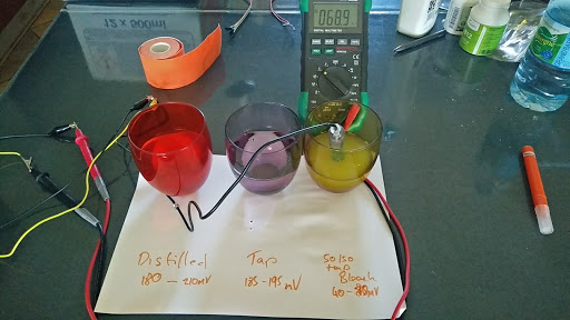

just tried taking measurements again. with a 5min soak interval.
results:
distilled water: 180-210mV
tap water: 185-195mV
50/50 household bleach/water: 40-80mV.
very odd - not consistent with previous readings and not consistent with expectations!

You may be thinking of pH meters. ORP sensors (by my reading) are not tricky to use. And you can't calibrate them (in the typical sense of the term): all you can do is "check" whether the change in reading is as anticipated between two solutions as different sensors will always read differently.
A checking solution also presupposes that you have some kind of signal conditioning. At the moment I am trying simply to understand the readings with no conditioning at all.
Input impedance of my meter is 10Mohm. I'd think that anything over 10k would be fine for ORP. Ph is different. If not what impedance do you suggest as a minimum and what is the rationale?
I had read the linked document earlier today. Thank you but it was not helpful for this issue.
My working assumption is now that the probe is badly constructed as I cannot see why else the result curve would be inverted.
