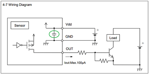

Show your schematic and also a link to the PIR sensors. It is likely that these also have a large capacitor across the power rails. Also state if the PIR sensors are to wake the device from sleep mode.

PIR sensor datasheet shows some type of internal capacitance, but it's just a bypass cap I guess. Just the PIR sensor will be used, not a "breakout" board.
