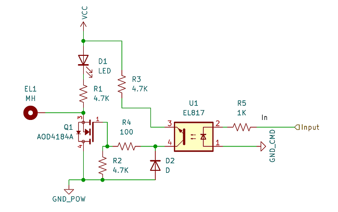

Hello everyone,
I made my first Mega shield with kicad and Eurocircuit manufacturer.
  • I would like to control 30 electro-valves from an aduino Mega
  • I tried a little circuit I bought online
  • I wanted to duplicate this circuit on my own shield :
I choosed the components references you can read on the image.
But it does not work as expected of course :wink: :
  • When I plug the shied to the arduino, supply the arduino with 12V, supply the electro-valves (+ and -) on the shied with 24V :
  • All the indicators LED should be normally switched off
  • When I set an output to HIGH, it should switch the corresponding LED on
  • And I should be able to read 24V between + and - of the corresponding electro-valve.

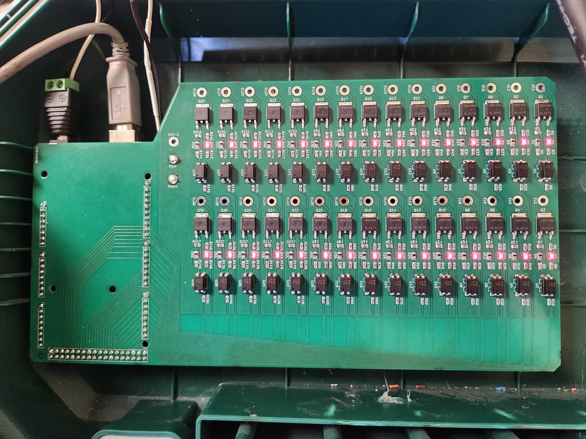

But.. :
  • When all LED are normally swiched ON..
  • When I set an arduino output to HIGH, the corresponding LED stayed swiched ON.
  • When I measure the voltage on the + and - of the corresponding electrovalve, I have NO voltage (0V)
  • When I measure the voltage at the output of the optocoupler, I read around 12V.

Looking at the photograph of the PCB, it looks to me as though you have at least two mistakes (x30) :
  • The pins of the opto isolators are transposed.
  • The source and drains of the MOSFETs are transposed.
On the schematic that you are copying, the Arduino output connects to pin 1 of the opto-isolator (via a resistor). You have it going to pin 2. - This means that the LEDs in the opto-isolator are connected the wrong way round.
Similarly pins 3 and 4 are swapped about.
The tab of the MOSFET is the drain, you have it connected to GND, where the source should be. The LEDs (and output pins) are connected to the source, not the drain of the MOSFETs.
The MOSFETS have an internal diode between drain and source, it is normally reverse biased, but by having drain and source transposed they become forward biased, hence putting the LEDs on.

  • I did check that all Mega output are set to LOW
  • I did test with a simple blink program, and I even check the input of the optocoupler with a multimeter, and it correctly display 5V when the output are set to HIGH, and 0V when set to LOW.

John, thank you very much, I indeed swap the components.. So stupid..

If the only error had been the opto-isolator, you could have got round the problem by mounting the component on the other side of the PCB.

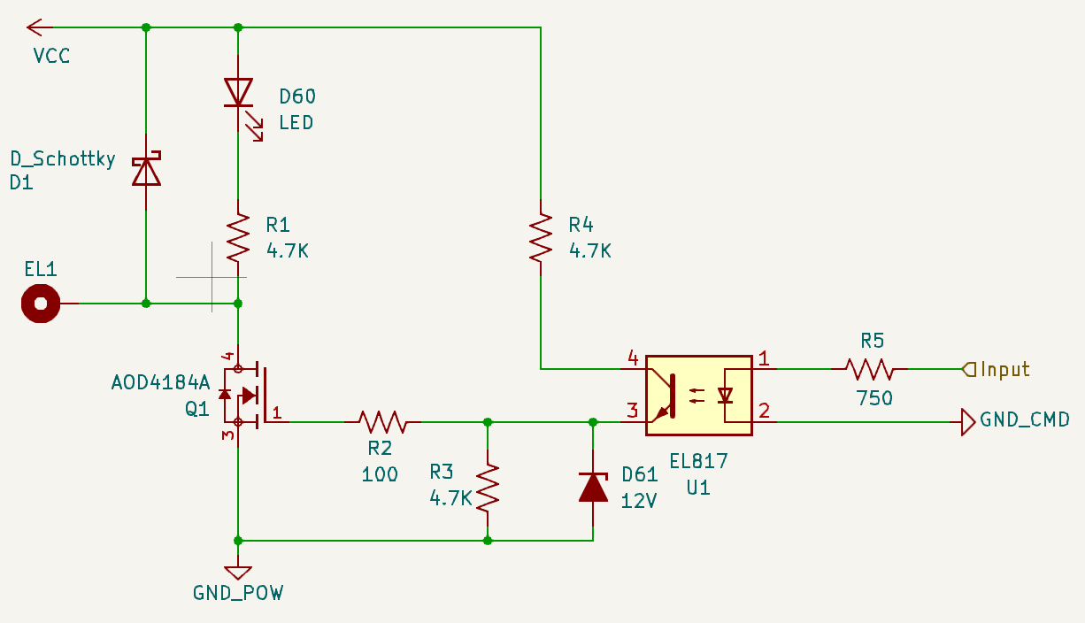

Hello,
Here is the modified schematic :
  • Does the flyback diode is a special diode ? Or can I use such diode diode datasheet
  • Does this Zener diode seems ok for you for D2 : zener diode
Thanks again for your help!
How much current do the valves use?

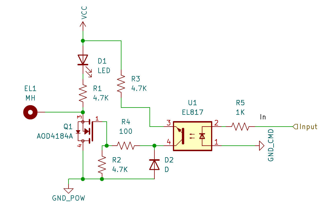

This is a more conventional way to draw a schematic
Notice that it is almost identical to the protosupply schematic.
I changed the 1K resistor to 750 to ensure thet the 817 get 5mA
Looks better Jim, but should the input not be on the left?
In most cases yes but the idea is to duplicate the protpsupplies schematic so it's easy to compare the two
Hello and thanks again,
I modified my schematic to match exactly the one you sent, looks better indeed and it help to understand. I change the 1K resistor to 750.
The EV is 0.2A.
If I undersand, in this case you advice a "Schottky" diode because it's able to stop more current than a normal switching diode ?
What do you think about the Zener diode I selected ?
Thanks again
I think the 4.7k resistor feeding the optocoupler (and eventually the MOSFET gate) is too high a value. With the other 4.7k resistor going to ground, you have a voltage divider that will only put HALF of VCC on the gate. That could be enough, or maybe not.
I don't think you need that resistor at all, actually (not the Zener or any diode in that position, either.) But something around 470 ohms would be OK.
(Another alternative would be for the 4.7k resistor going to ground to be a much higher value, like 47k.)
Zener diode:
Use this zener. Here is why, it is 14V 5% so the actual voltage will be somewhere between 13.3 and 14.7. Since the MOSFET gate is +/-20V it is low enough to protect the MOSFET but higher enough to make sure the gate voltage is 12V.
Schottky diode:
Schottkys are faster than silicon and are no more expensive.

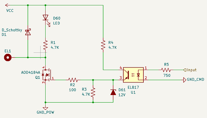

Hello Jim,
Here is the updated schematic, it should be exactly the same as yours.
Thanks for you help choosing the components, it's really not easy to be sure of what I'm doing...

That is fine except you should note the the zener is 14V.
Also you should correct the AOD4184 pin numbering, it only has 3 pins
